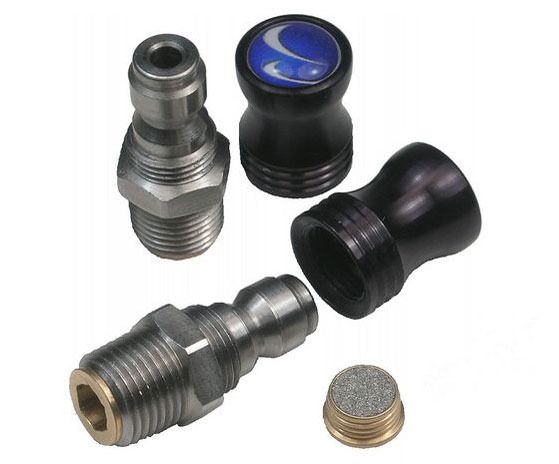

WOO HOO! My fill nipple prayers have been answered!
Yes, they cost much more than what I had budgeted but I *like* them! These are going on the Millenniums.
Fully captured pin plus a sintered filter.

VERY nice, Mike.... Who makes and sells those?....
SeanAT
Posts: 100
Re: Millennium Pumper Production - *The Beginning*
Reply #330 on:
January 15, 2015, 02:21:20 PM »
Quote from: rsterne on January 15, 2015, 01:13:54 PM
http://www.ansgear.com/Bob_Long_Filtered_Fill_Nipple_Black_p/boblongfilteredfillnippleblack.htm
Here's a different brand of captive valve fill nipple that's a little cheaper but doesn't have the filter...
http://www.ebay.com/itm/Custom-Products-CP-Fill-Nipple-/331425093864?pt=LH_DefaultDomain_0&hash=item4d2a7998e8
Last Edit: January 15, 2015, 02:23:38 PM by SeanAT

I just ordered 10 of them from ANS Gear...this is the only fill nipple that Jack Haley would use in his guns, so I figured they *had* to be worth the cost!

Note the comment on the website linked to about the screw on dust cap sticking in place if there is a tiny leak in the check valve.... Worth consideration?....

You can always drill a small bleeder hole in the screw cap

That is a good price on the CP ones. I just ordered 6. Those are what I use on my builds.
I have a Haley and it doesn't have one of the those fill nipple on it. I will have to look and see what it is.

I found an old post on the Yellow from 2010 where either Jack or someone had said that's all he used on the Haley builds...
I read the cap issue and it becoming stuck if the fill nipple leaks - I planned on drilling a *tiny* bleed hole in the cap somewhere to alleviate that becoming an issue.

Mike before you drill a bleed hole I'd check to see how tight the threads are. It's hard to believe that a threaded cap would be air tight unless (thinking as I type
) it's not the thread but the two faces making the seal.
Neat fitting, is it 1/4 npt?

My Haley has a CP products on it. I think they are a newer than 2010 product.
I snatched up all 6 that the like had above. They are normally $15. I usually get them from CP and the best they have done is $12 ea when I bought 10.

Tom, the fitting is standard 1/8" NPT for a fill nipple...not sure what the thread for the cap is.
I will see how tightly the cap fits on...they shipped today and should be here by Monday of next week.
Doug - Yeah, it might be...I was on *internet search mode* when I ran across the link to the Bob Long fill nipples on the Yellow. I may have gotten my information mixed up but Haley was mentioned with these somewhere.
Here it is! It was 2012...Jack said he only used 'these' and they were $15...he probably meant the CP's...
http://www.network54.com/Forum/79537/thread/1349466952/Source+of+HPA+fill+nipple+with+captive+check+valve-
