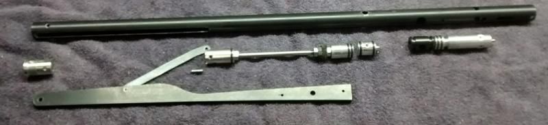

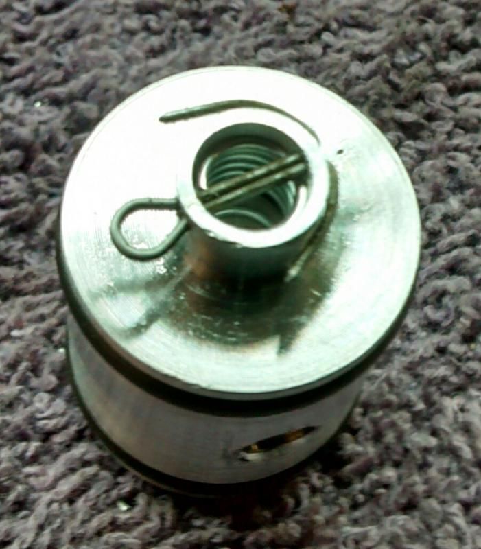

Its a Disco tube, so the OD of the piston is .740"The length of the piston assembly from the back of the follower to the face of the piston is 7.4"... the stroke length is 7.2" if measured from the center of the pivot pin hole.The follower & piston head are bottomed out tight onto the rod...then there's the lock nuts.I'm locating the check valve in the tube so that there's only a few thousandths between the piston face and the check valve face...which will make adjusting the flat top piston really easy.Mike
One thing I forgot to mention - Jim is going to make the pivot pins out of 316 stainless steel, stake a ball and spring on the ends (just like an AR15 pivot pin for mating the upper & lower) then harden the pin - That way the rifle is truly *field serviceable* without tools...Ok, at least you can remove the piston assembly with just a small punch for the pivot pin and link pin Mike

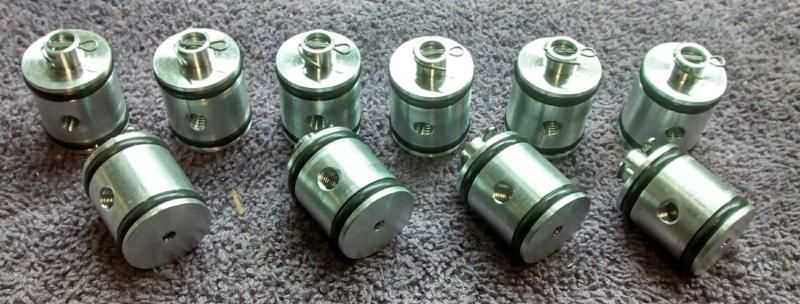

I like the idea of using the #113s everywhere.... they are less prone to shaving on the gauge and screw holes, and it's nice to have them standardized.... Like the idea of a spring loaded main pivot pin as well....Bob
