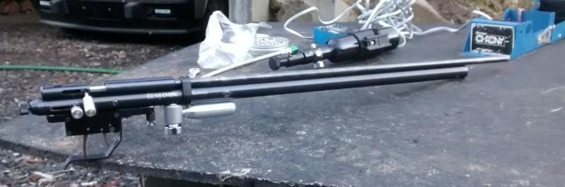

January 20, 2015, 09:05:46 PM »
***Update***
Today I got to tether a Millennium powerplant @ 1800 psi. I got my Teflon rod and made a transfer port on the lathe.
I hit 892 fps with a King and 730 fps with a 37gr slug. What a difference a tight seal makes!
Remember guys, I'm using a 54 gram Prod hammer that has had the hole in it bored out to .375" to accommodate the .360" OD hammer spring I'm using...I have no idea what the hammer/cocking knob (a steel bolt handle for now) weighs.
I'm trying heavier hammers tomorrow to see what I get.
Here's a pic with the temporary factory top end I have on it...
More to come tomorrow evening.

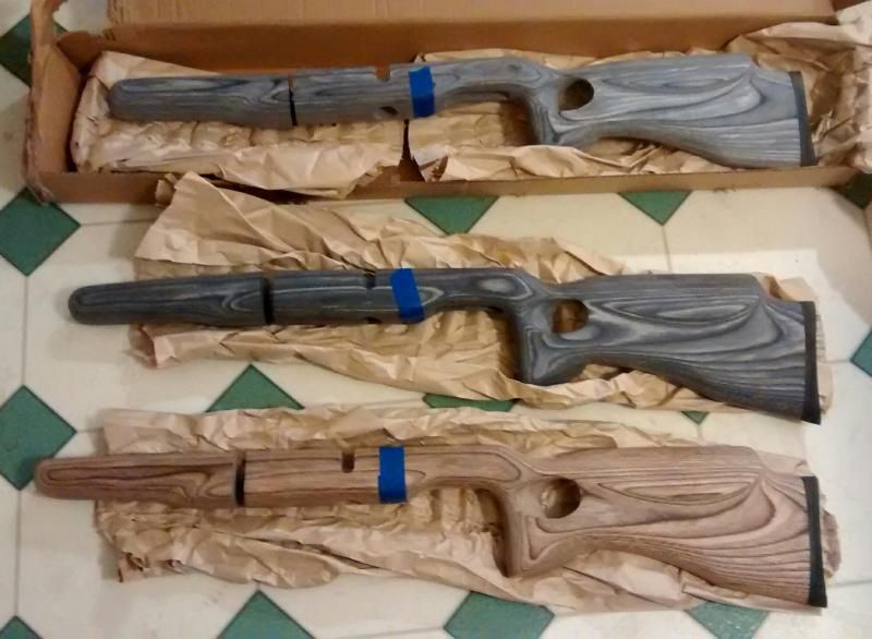

CarsonRatSniper
Posts: 1795
Re: Millennium Pumper Production - *The Beginning*
Reply #357 on:
January 24, 2015, 04:23:14 AM »
Thanks Guys!
Here's what I got today from Norm @ Discos R Us...2 Pepper & 1 Nutmeg.
They obviously still need to be finished with polyurethane but them look *GOOD*!
I will post a pic of one on a powertrain tomorrow.

MRT949
BUY ONCE CRY ONCE .
Posts: 267
Real Name: MIKE
Reply #358 on:
January 24, 2015, 10:23:42 AM »
Gook looking stocks.
