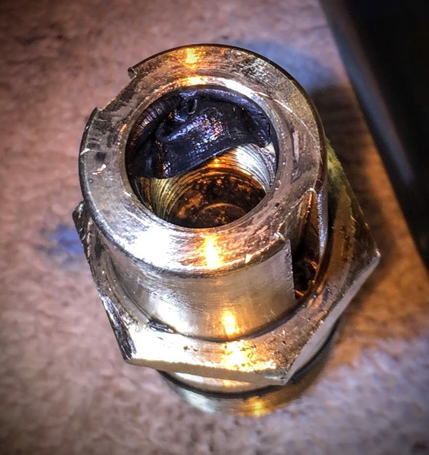

I don't want to derail the SSG thread with questions about my specific setup, so I am posting my question here... First, I was very successful in making and installing an SSG with my drill press, bench grinder, and some dremeling. I used my smartphone to make a super slow motion video (240 frames per second) of my gun shooting before installation, and it recorded an average of four 4 bounces per shot. It recorded NO bounce at all with the SSG installed. I am able to achieve the same 900fps with 10.34gr JSB's as before, and hammer bounce has been stopped cold. Awesome!
