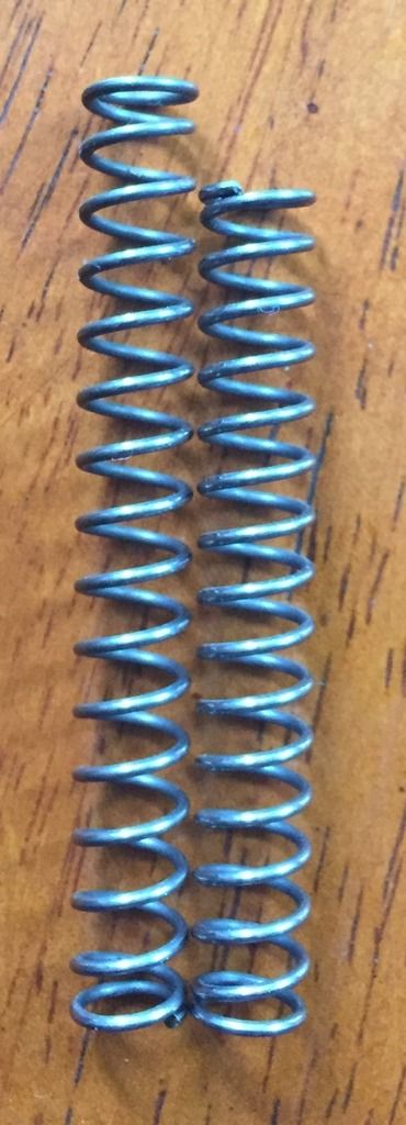

EDIT: Hmmm. Look at the differences between these springs:Neither of them have been clipped. The short one is what has been in my gun for a few weeks. The springs were identical when I got them. ...is this normal? I am gonna be clipping the short one in a few minutes...
... spring on the left (longer one) has been "stretched".
The shorter spring has been "set".... My guess is that if you take the long one, put it on a rod so that it can't kink, and compress it fully (to coil bind), just once, it will be the same length or shorter than the short one.... That is why I always set my hammer springs before I use them for the first time.... If you do that, they will never change again.... and neither will your preload settings....Bob
