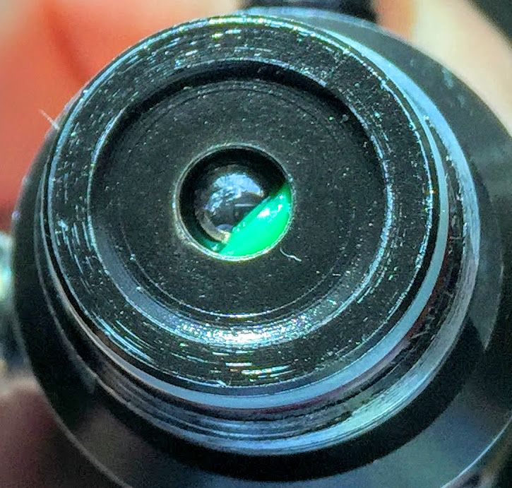

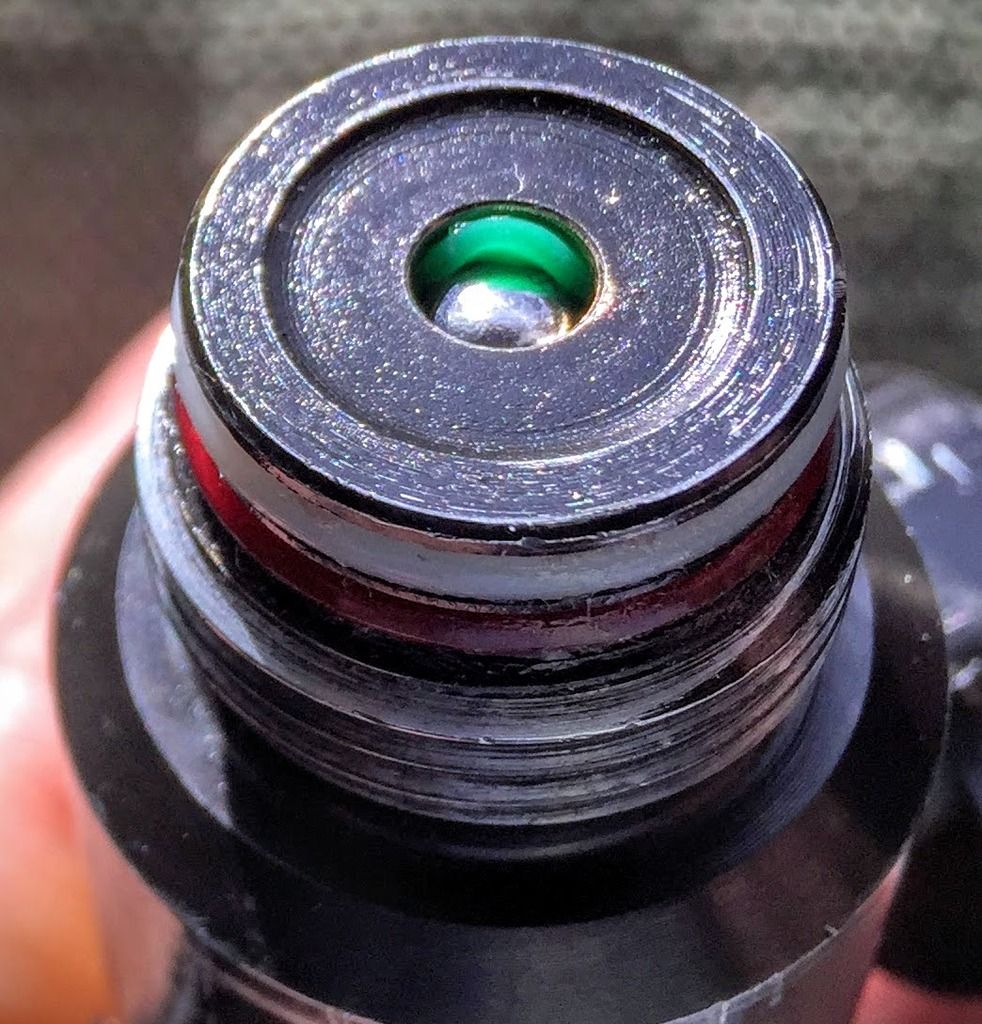

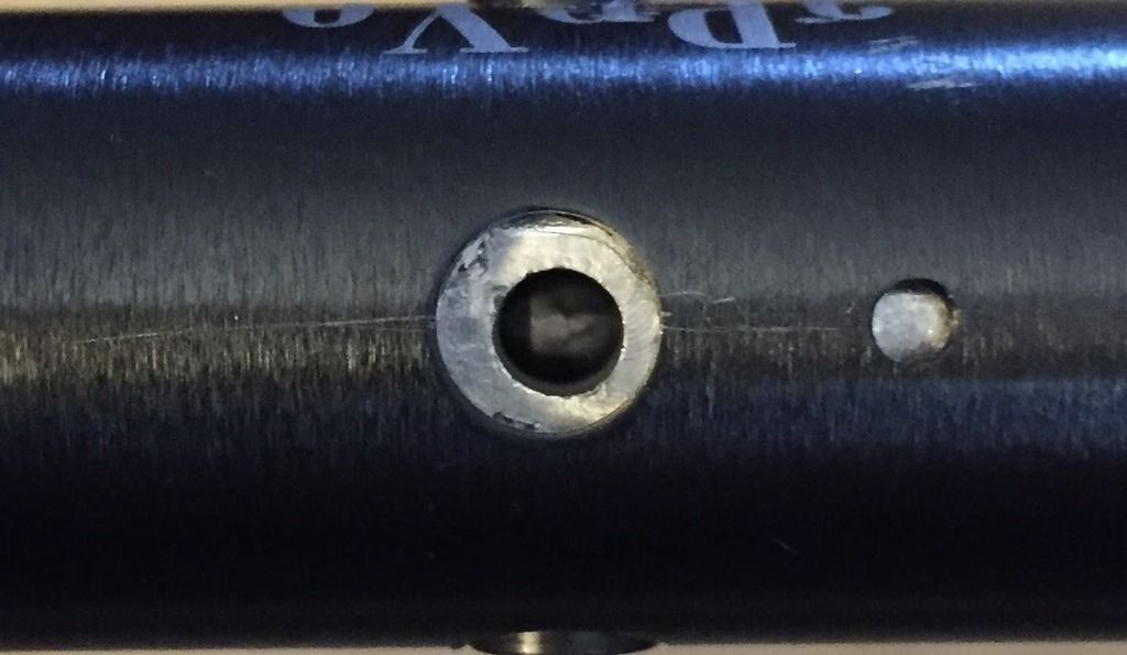

Not sure how I feel about this ball valve design. A coil spring holds the ball up when there is no pressure in the bottle. This has happened to me a few times now when I evacuate...
Quote from: aPpYe on December 03, 2015, 07:05:02 PMsigh. I need to stop using my phone on this forum. I was referring to the little green oring that is in between the ball and the housing.Autocorrect passes me of.Steve
Post those photos in the Ninja gate and have Ray comment....
I think you may be "Evacuating" too quickly. This cools the seals to a point that they are distorting.Also with your pressure going up to over 1700 it sounds to me like you are getting regulator creep. I've had 2 of my bottle at 1500 for a few months now and the reverse bottle gun has a gauge between the gun and tank. Never has it gone up over 50psi between temperature changes.
Actually, now that I think about it, when initially pumping up a tank, you are taking a large volume of air that contains an amount of heat and compressing that air, along with at least some portion of its retained heat. When room temperature air is continually compressed into the tank the temperature will continue to rise because you are taking a large volume of warmer air and putting it into a smaller space. I would imagine this increase in heat rises by some mathematical number in relation to the speed at which it is compressed. This compression is what causes the heat to rise in a diesel engine cylinder, allowing the fuel to combust, which is similar to what happens when a springer "diesels"...I am pretty sure I have read somewhere that there are those who have attempted to take advantage of this to increase velocity... I gotta read on whatever results people have had... I wonder if it can be reproduced with a level of consistency that would allow for consistent fps. I am sure someone has tried... On to google!
