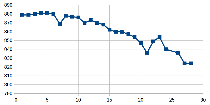

What would be a realistic goal for maximum efficiency (at the knee) for a 24" 2400kt in .177 with 10.34 JSB heavies? I want to keep knee velocity well under transsonic turbulence, so I don't really want to shoot much higher than 925fps. I know I can get the knee to that velocity with a 1400psi set point. I don't mind the ~850fps I am at now, but I would like to achieve something better than 1.13fpe/ci at the knee if I can... Lower velocities and lighter pellets are secondary concerns, and I understand that these velocities will increase below the set point if I am shooting on the downslope rather than the knee... When I am shooting at 5fpe indoors, I am fine with that. At those power levels, shot counts before even getting close to set pressure is ridiculously high anyway...
