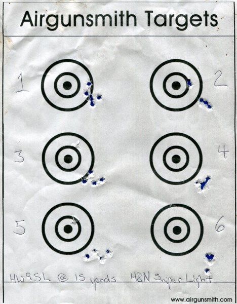

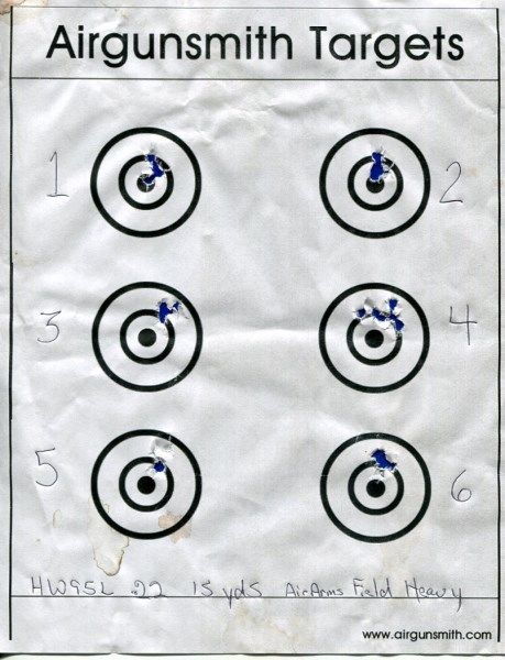

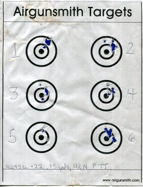

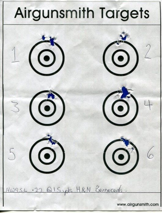

Today I shot H&N Barracudas 5.51 at 15 yards to see if it would group. Throughout this session I adjusted the scope down 6 clicks,which had no discernible effect. The groups are ok,I just wish I could do the same at 30 yards.
