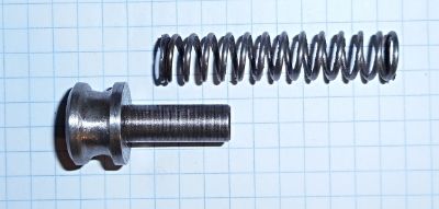

Has anyone tried this
depinger mod? Your thoughts?
-Nothing wrong with doing it, but honestly it's not a necessity.
