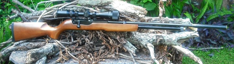

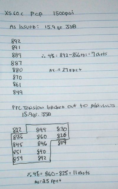

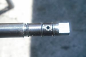

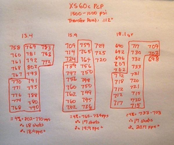

Re: FDPCP, differences between the Gen 1 vs. Gen 2 models ? ? ?
December 06, 2014, 04:51:19 PM »
Out the box (Generation I .22) here is how she did:
Reducing the transfer port:
Haven’t a clue what’s changed with the Gen II, but suspect it’s more about having to use new part rather than parts on hand.
Not a bad looking little PCP:
