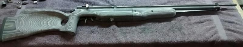

Here's a pic of the action with a factory top endThis is one of the straight cut stocks - the fore arm pump handles will be cut at a slight angle about 3" farther back than this one.The entire shop is dedicated to the Millennium builds beginning next week and I have all week off to work on them with Jim...we should have pics of a completed rifle by Valentines Day.Mike
