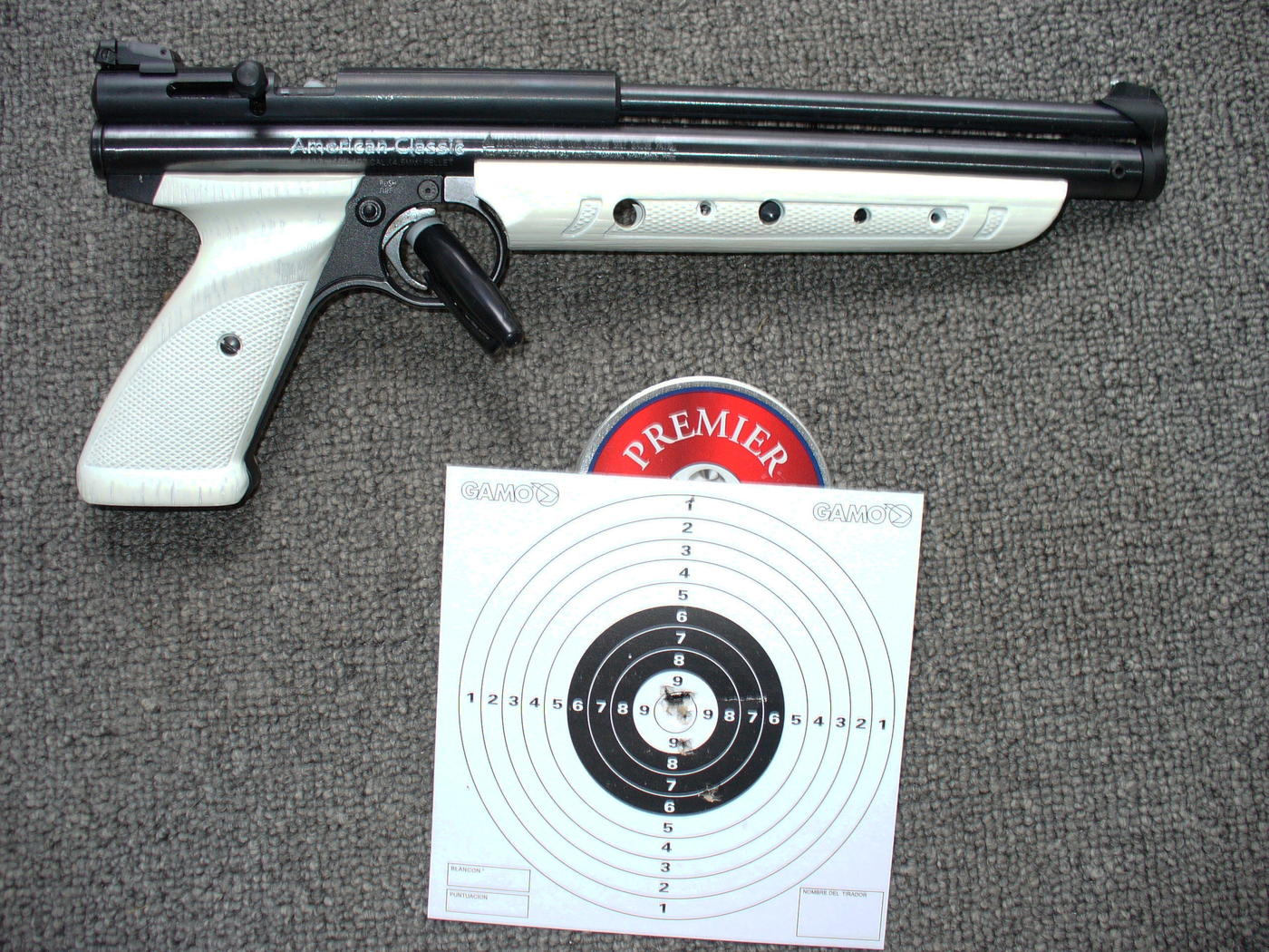

Quote from: silent_airman on May 15, 2013, 05:20:51 PMQuote from: BigErn on May 15, 2013, 10:37:01 AMQuote from: silent_airman on May 14, 2013, 10:08:12 PMOk, Ernesto, spill the beans. How did you do all the different colors? You can tell us. You're among friends. Lol.... No secret here silent, I spray paint and clear my guns. It's alot of work but it keeps me busy and I really enjoy it.What paint do you use? I assume you primer as well? Rattle can or airbrush? Rattle cans. Strip and sand the metal first, then DupliColor etching primer, Rustolium paint, then Rustolium matte clear.
Looks cool Ern.I like the skeleton AK stock.Nice choice of color too!

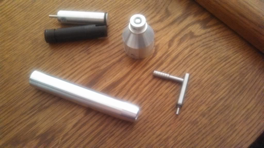

Here is my 1322 backpacker creation. Cr. Steel breechProd barrel and shroudStorey LDC Flat-top piston and ported valvesecondhand custom brass triggerPVC breech riserPolly tube transferport Drilled and taped a new (small) breech screw.1399 stock with a riser pad/stock pocket I have been working on.. Next step will be new bolt probe and a hammer spring adjuster... but I'm in no rush, this thing is hot enough as it is..
