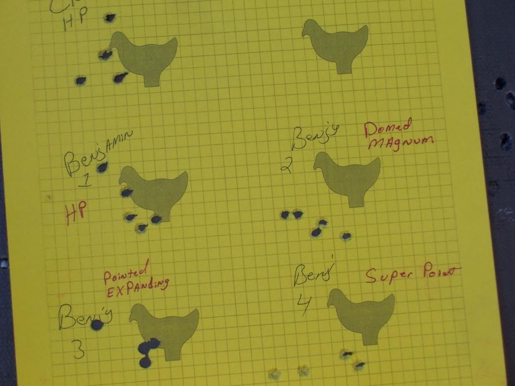

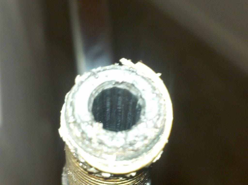

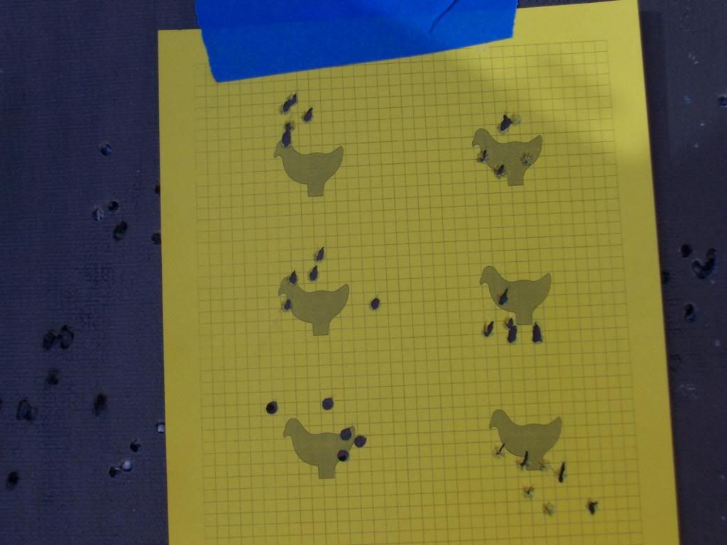

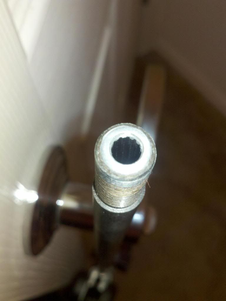

OK this rifle is starting to show promise. However shooting at paper is marginal at best, and going 0 for 3 on pigeons( the original intent for this rig) I would really like to put a different barrel on this thing maby a LW or FX...Well I think I should look at the crown!
Rifle is cleared just missed pigeon. looking down the barrel

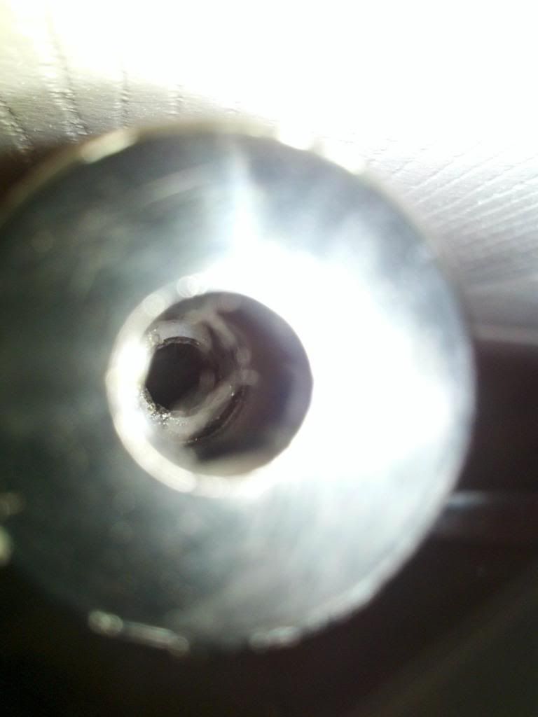

OK that looked horrible, lets take shroud off and have a look at it.
Beautyful

So We now need a Rasp! Well I used two files on this the first one was semi course to get even as the barrel had a angle to one side. Got it straight then used the fine file to remove tooling marks that I made. I then used a dremal cone stone and by HAND slowly worked on the actual crown. After that I touchet it up with 600 and 1500 Wet dry paper..
OK so what time does the sun come up I gotta go try this out now

Good luck Paul. I hope the crown job sets it straight.

Cleaned up pretty good there. Don't forget to use a pull through and clean the barrel. Also expect to put a few hundred shots through it to season the barrel and break the rifle in before you start seeing real accuracy.

@ paul68 Yes I pulled a few patches through before I reinstalled the shroud. I have about 500 pellets down the tube at this point but only about 50 after the tune and crown. I went 5 for 5 on shot gun shells @ 25 yards and was pretty pleased with that at this point. I have noticed that when I use different pellets it takes several shots for them to aclimate. Before the tune I dont think any pellet really stoud out in my mind but the CPHP got my vote, After the tune H&N FTT really made a big leape forward. After the crown the JSB diablo heavys started to shine. I really hope the Barracuda hunter ex work out for my hunting pellet but the poi is so different I cant go back nad forth to easy.

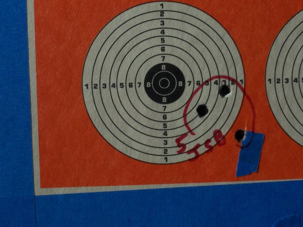

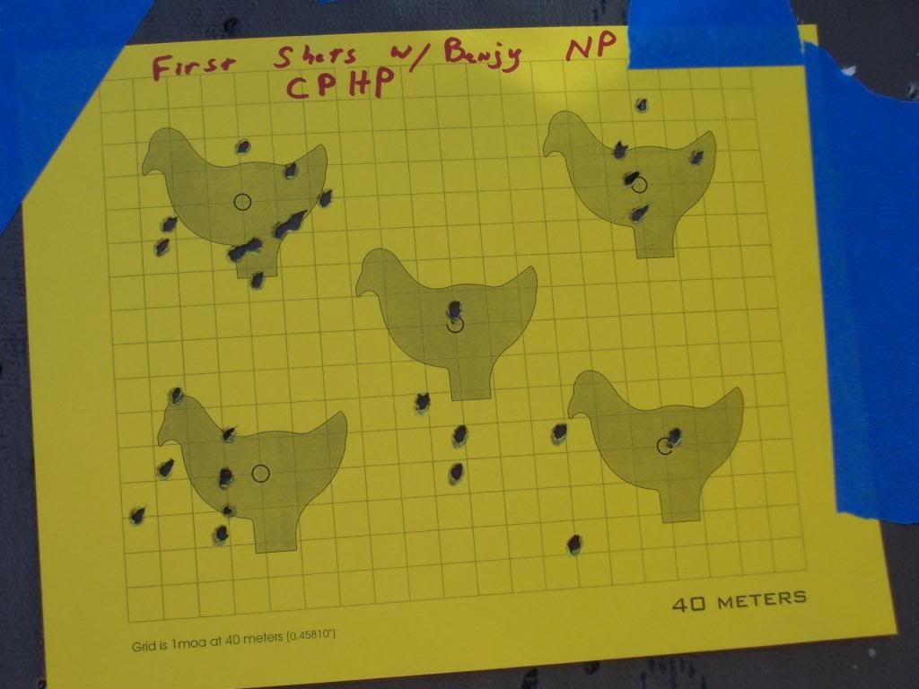

OK when I purchased this trail NP in Nov. it was preowned but box stock. here is what it did. at that point:
lots of vertical stringing, The trigger has got to go, I did a washer for a while and was an improvement but the GTX
trigger was amazingly different!
This is just after trigger
still not pleased so a tune up and getting rid of chinese greese and relube with moly past, GRS, Apex seal, and brass pivot washers:

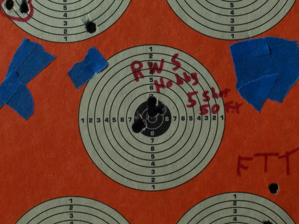

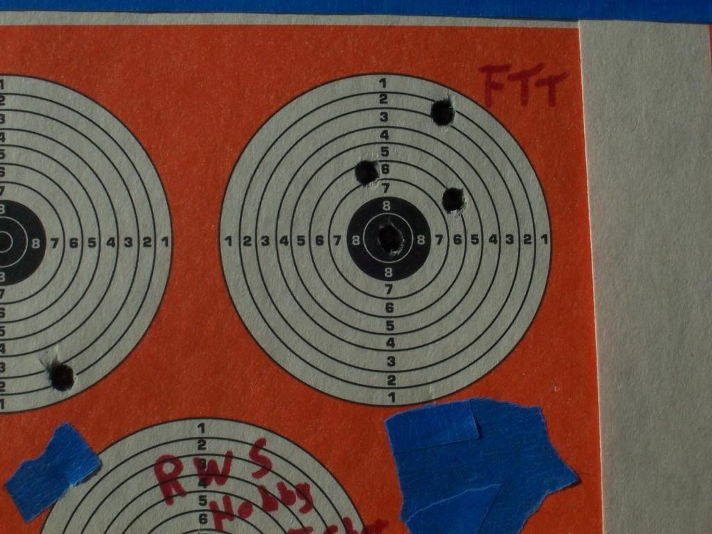

These targets were shot using FTT @ 25 yards, there are at least 4 in the 9 ring on both so I know the potential is there. + just after these shot were taken I missed a pigeon at 15 Yards. I thought I should look at the crown.
It will consistantly hit the intended target at 200 yards!
