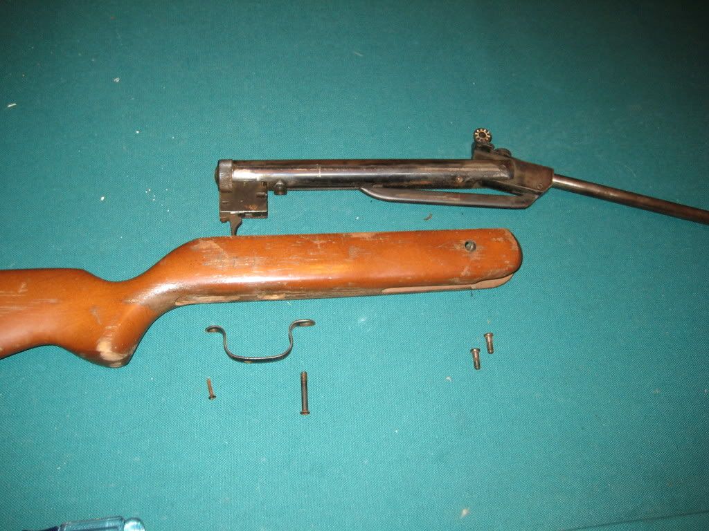

The lighter stocked gun is a j c higgins made for them by crosman. the other is a crosman 400. The jc higgins is just a parts gun as i needed some parts for the crosman. now i need to get a seal kit for the crosman. it had several parts robbed off it when it was new, never shot but seals are dried out.i got the j c off the net for parts.

my bad the light stock is the crosman . it is a better grade of stock than the j c higgins has . but the j c higgins has a stainless steel bolt handle . if somebody hadnt took their vice grips to it id put it on the crosman . you have to remove the plug at the end of the bolt and stick an allen wrench in and tighten the set screw up to keep the bolt handle tight . hope to get a kit soon and see how nice it shoots . i see i will have to get some flat nosed pellets or they wont feed out of the magazine . and bet it takes a lotta co2??? also i discovered the j c higgins has a power regulator screw in the back. im thinkin about installin it on the crosman but not sure if it will interchange without usin more of the parts gun, the blueing is excellent on the crosman the higgins is rusty. just anothe rproject for me to do
