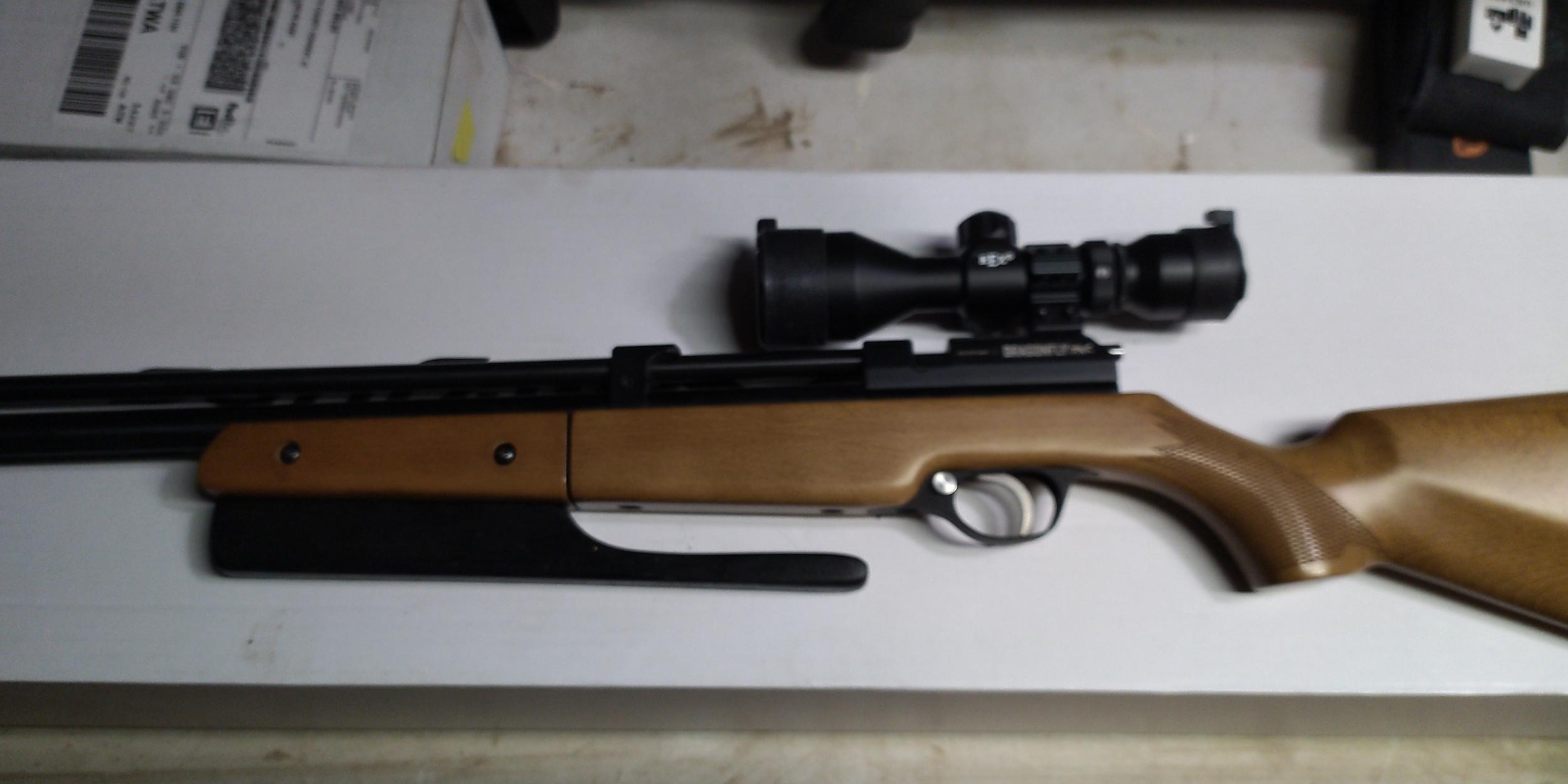

Hey Guys
I got a New Dragon Fly I, 22 cal rifle, it's the 1st model of this series,
and it is a beast to pump as compared to my Model II cal version.
I got a strong itch to see what makes it twitch and if I can make it
slightly easier to pump up.
There is a VAST DIFFERENCE between these two models.
I can tell you now, I WON'T be doing 3-5 shot groups per each pump level test,
for the average, not the way this thing pumps.
I compared it against my Sheridan's and the Sheridan is easy, next to this DF I.
Anyone else have this same model?
What are your thoughts and suggestions?
Tia,
Don

So the pump handle of the DFs end with a block of wood as a forestock that meets up neatly with the stock proper, the part that holds the receiver, trigger etc. Grab this forestock and pump away. But what if one made a replacement forestock that extended below the stock proper, like a hamster, so one could grab the hamster and pump, with added leverage?

Don's DF II thread is the most in depth I am aware of!
I don't shoot it much anymore, but I shot the DF I nearly everyday for a couple of years.
The transfer port on mine needed some cleaning up. I made a barrel band of sorts between the muzzle cover and the bottom tube. This eliminated the POI shift I had been seeing.
I prefer the heavier cocking. Find the right posture for pumping and its enjoyable exercise. Putting some cushioning material in the pump handle can help dampen the clack. I wish the arm was longer, however, kind of like the 362 length.
A correctly and securely attached scope can serve as a pump handle for leverage. I used a simmons at first, but since I shot it so often I put a hawke vantage 2-7 on it.
I often shot 1 or 2 pumps, chasing my curiosities about low velocity accuracy. The ftt greens and spitzkugels typically did well.

I made up an extension, have not installed it yet, I just pump to 4 or 5 or get the DF2 and pump to 12

I can tell you this bit of info, from just handling the DF I model,
it will not be as accurate as the DF II model.
I can slip a .010" thick feeler gage between the bbl and the rear sight mount....
there is that much slop between the bbl/sight mount, all the way around the bbl,
and if you put any pressure on the bbl muzzle.
You can almost make the muzzle touch the end of the pressure tube, with very little pressure on the bbl..
I will see if the DF II front sight can be fitted to the DF I, to reduce/stop this sloppiness
of this bbl..

Where did you find that add on pump handle, I LIKE it, a lot.
Bolt on, or replacement of the pump handle?? Dimensions??

I just laid it out on cardboard then cut it out of some 3/4 ply. I am re thinking this now and may try a larger chunk of wood and make it a one piece. My original idea was just to bolt it to the wood pump handle as seen in the photo.

James, are you thinking of cutting the stock piece with the trigger back a bit. For instance, the 362 (and maybe the mk II?) have the stock piece by the trigger shorter and the pump handle longer for better ergonomics.

April 07, 2025, 06:06:55 PM »
SB
That won't help on the 1st model I of the DF.
The stock action screw for the rear sight is approximately .850" from the end of the stock and where the cut is for the handle pump'. so it can close down completely.
James design will work, I think a whole new 1 pc pump handle with the longer rear section (like his photo shows), would be the Cat's meow...
By rough measurement, the front section would have to be around,
6.00" long x 3.00" deep, 1.500" thick, (stock width) and the
long end would be about 12" x 1.500" wide..
I have got a pc of Pine wood 2" x 4" x 15" long, I make a rough shape of it
to see the results.
It's going to have to be from a tough type of lumber, ie: Oak, Hickory, Locust
to be able to take the leverage of pumping.
Your thoughts and suggestions....

Hickory is hard to stain (blotchy) but a good choice for weight and toughness. Locust takes a stain better than hickory and it is harder but more prone to cracking. IMO I'd go with Locust.

Guys
I am sorry to tell you this,
But, I can't find any "O" rings for the barrel in the US,
so until I can seal this bbl and stop the leaking, I'll hold off doing any testing.
As soon as I get the bbl sealed, I start the tests, like I did on the DF II 22 cal model.
I am thinking real hard on re cutting the OEM Grooves to a more common size,
as there is a little bit of room to work with.

Well Guys,
It's Off to work I go, hi ho, hi ho...
A very nice lady sent me 4 "o" rings to fit the dragon Fly I - 22 cal rifle bbl.
I plan on doing the same type of test as I did on the DF II -22 cal,
I can tell you it won't be a 5 shot test per pump number like the DF II,
as this thing is a bear to pump once you get above 5 pumps, and per the instructions
the max pump number is 8 pumps per shot, I may go to 10 pumps max.
I'll detail and take photo's, when I check internal pump rod depth,
along with all the other spec's and diameters etc,
so here is your chance to add any info to check/test be for I start the test,
I just wish I had a 177 bbl to go along with this test.
Your Thoughts and suggestions...

I did mount and test the pump handle extension over the weekend, it makes 8 pumps doable, make sure to leave maybe 1/4" more gap than I did as at 7-8 pumps my 3/4" plywood flexes.
I mounted it by pre drilling the OE handle for grywall screws, then pre drilled the ply to take the threads without splitting. Holding solid. Six pumps is doable easily, one thing though is one has to reach their arm out fully to get a full pump cycle similar to the DF2.
Member Map.
[smg id=6202]
