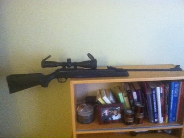

I like the 350 pro compac so well that I am thinking of doing the old chop job on my .177 12 land barrel. This gun shoots great. I know that the 12 land has been a topic on here as a barrel that most people don't like due to accuracy. Having a good one I hate to do this mod but what the heck. I'm sure that starting with the 12 land is not the most desirable one to start with. Feuerkraft 350 has a barrel length of 19.63" and the pro compac is 15.75". Around 4" +- difference. I have the tools to do a good chop and recrown at the house. Any advice is welcome. Should I or not perform this mod. I have read on here and the net of some pros and cons. I know people may not want to have this topic started again. Losing FPS does not bother me, grouping does. I know barrels are not cheap for this gun. If I ruin the barrel I will still have a good stock and power plant that will be worth something. I would really like to take the barrel out of the breach and cut that end.

Barrel to be here tomorrow. I have broken the gun down and given a drop of chamber oil. I have given it a light oiling of the spring area and letting it sit. I am not going to do a lube to it because I am going to order a vortec kit for it and will wait till I see how this new barrel does. In the mean time I have cut about 2 " off of the front forearm and rounded the front of it and applied about an area 1/2" coat of bedliner to the sanded area. Looks darn good. I also cut a 1 1/2 off of the butt and reshaped the rear pad. So over all the stock is from from to rear 3 1/2" shorter. The front looks like the 350 true mag gun. Spun me a piece of 3/4" alum. and made me a muzzle break 6" long and put set screws in it to hold it. The break on the 350 PRO is a bit heavy and much longer. I may put a tad of JB weld on it later after I play with it. Going to test it at different settings first. Breaking down the gun is really no different than any other gun I have torn down. Just made a little different. I was going to put this barrel on my 350 .22 and sell the 350 .177. That way I would have the best of both worlds in one gun. NOT!! What the heck~! I will just leave the .22 alone and make a break for it and keep the .177 for the gang. Since the stock mod worked out so good I will later do the same to my PRO. Well, at least cut the butt off because with the 3x9x40 scope I have to lean in to the gun to get the scope in my sights due to the front bell not allowing it to go back enough. SHORT ARMS!!!! This has been an enjoyable project so far.

Barrel arrived this morning and the gun is back together with all the Mods. So far the gun is grouping well. No fliers, stringing. Shooting rws 8.5 gr at the time and the gun is much louder. Some of it may be the chamber oil or at least it was the first 5 shots. Run about 50 through her and seams to be great right now, I feed it some 10.5 gr and see if it doesn't tame it down. I really like the shortening of the butt. I also did a little cheek pad. Stock mods made a different looking gun. Back to the bench!!!

geesh maybe you should get a couple lottery tickets
You seem to be ona winning streak.....
what is that muzzle brake on there??
