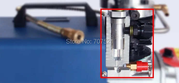

ebay prices appear to be coming down, lot of units with the cyclone separator but not the adjustable shutoff pressureat $300 now incl shippingpreviously were around $350
Quote from: lennyk on September 15, 2017, 08:23:31 AMebay prices appear to be coming down, lot of units with the cyclone separator but not the adjustable shutoff pressureat $300 now incl shippingpreviously were around $350what is this "cyclone separator" ?? is this something new we dont have ??
Quote from: gendoc on September 15, 2017, 08:28:30 AMQuote from: lennyk on September 15, 2017, 08:23:31 AMebay prices appear to be coming down, lot of units with the cyclone separator but not the adjustable shutoff pressureat $300 now incl shippingpreviously were around $350what is this "cyclone separator" ?? is this something new we dont have ?? all the Yong Heng models have it except the Simple modelcut-a-way viewUploaded at Snapagogo.com
John, I was referring to the golden filter, it sees the full 300bar pressure. It should be hydro tested to a minimum of 450bar and desing should withstand 3 times the working pressure without rupture. Thats ~900bar. Makes me wonder does it actually hold that?Marko
