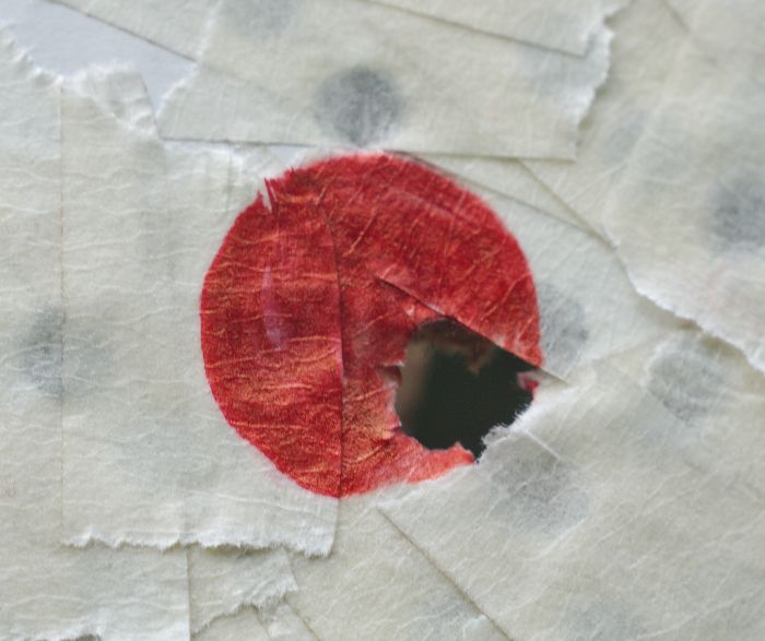

Bob, I had to rezero with a new set of rings, I broke the rear ring of my other set, so here's an image of the last 3-shots that I shot at the 50 yard target, this evening, not zeroed yet: This is typical of how the NOE 51-FN BBT's are shooting from this LW 1-17.22" twist barrel, at 965-980 fps. Is it possible that the 1-14" TJ's .25-Auto liner could stabilize a heavier 63-67 grain bullet well, at airgun velocities of 1000-1050 fps? If so, is it possible that you'll design something like that in the future?
