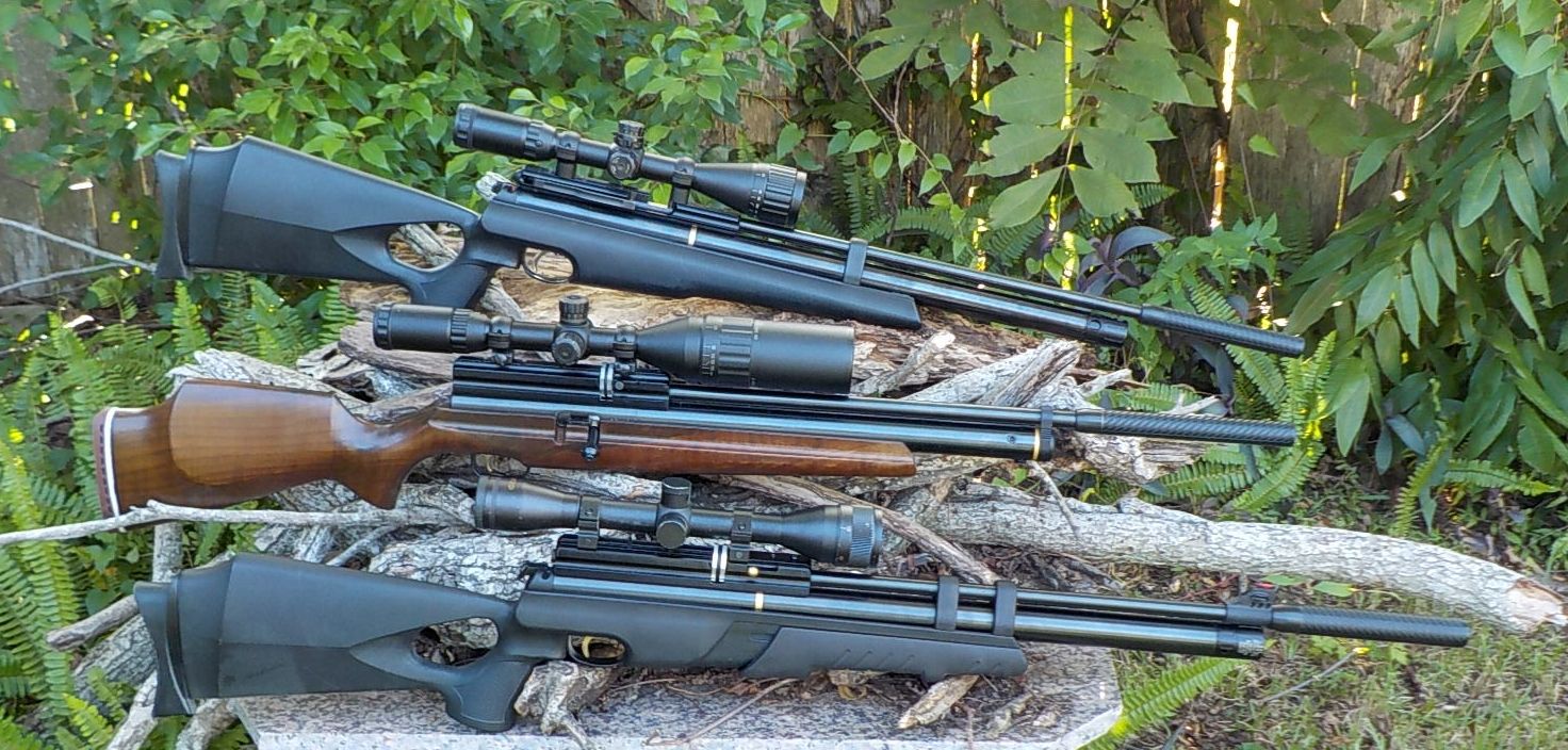

I've not had any trouble getting good accuracy (as good as I got with the M-rods) so long as I did the following:
1. Adjusted for a nice even output on the chronograph. May not mean much, but having them launce in a nice predictable, smooth bell cure has NEVER hurt.
2. Made sure the barrel bands were tight to the stock, the air tube "free" to be unscrewed and screwed in without binding, and the barrel o-ringed to the top of the band "close but not binding" (meaning I can unscrew the set screws on the barrel and pull it straight out if I had to). I still prefer one barrel band, because it's easier to set up that way, but two bands won't hurt (just harder to get "right").
3. Never wind in the striker spring to absolute tight. Too tight, and it compromises magazine cycling and sear setting. Always leave enough space for a little "slack cocking" movement AFTER you feel/hear the sear set on cocking.
The "off" one was the 5mm Webley/Hasan Raider. FINALLY figured out the 5mm barrel had a smaller diameter barrel shank that the other two (after all, they were a small run of 5mm's...Hatsan doesn't deal in that caliber, so the barrels were an independent run from somewhere). With too small a shank, the o-ring barrel would kind of misalign with the mag. if screwed down tight-tight. If left "kind of tight" it would align, but wiggle.
For that one, I made the barrel shank "fatter". Basically remove the barrel, removed the O-rings on the barrel, degreases it, silver soldered it, "flung off the silver solder so it was basically "tinned" all around (which increased the diameter slightly), cleaned it up, added the or9ngs, and got it to both screw down tight-tight AND line up to the magazine.
Can tell for them ones shown, I rather like the SHORT TUBE (180cc's) and a detachable LDC. For me it works out better. A shorter rifle (LDC OFF) out in the woods when I don't care how loud a PCP is (it's never going to be as loud as a .22RF or a 12gr.) or a quiet rifle (LDC on) for suburban shooting.
What I am missing in that line up is a .22. and I'll think about one just for completeness....but it's more likely to be another short-tube Hatsan than it is to be an M-rod.
