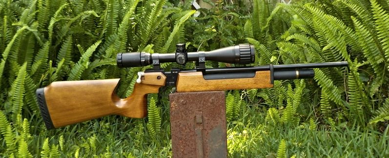

AA s200 .22 (yeah...it's coming up on 15 years old...so what?):

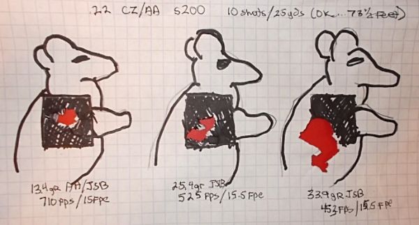

The 4th test: low speed:
Same kind of rat-targets with a 1" square aim point.
1. So....it's still crappy with the 34gr. JSB's... "OK" with the 25.4gr. JSB's...and still shoots great with the 13.4 (either AA or JSB...it don't care).
2. Moving on to +40 yards would likely just make the "crappy" more crappy, and the "OK" into crappy.
3. Not the signs of instability that the Chief showed ("tails" on the paper holes).
4.. Finally got to a rifle tuned so that the really heavy (33.9gr.) pellets DID NOT earn more energy (although it was basically a tie).
Which brings me to the question.
Even if the super heavy pellets did shoot well at 450-455fps/ 15.5 foot pounds...why?..what possible advanatge would they have in a moderate power PCP?
Save them for trys in PCP's that can manage high enough speeds for high (in .22 terms) energy.

One of the old, single shot M10's (think there is a repeater also sometimes called the M10)..and actually had to tone it down a bit. So I did reduce the size of the transfer port a little to calm it down with 25.4's.
Sooner or later, I'll try it out at longer range. Not really how I use the few I keep at higher power....just me. Normally I'll not shoot live critters more than 50 yards away, the powerful PCP's with heavy weight pellets aren't for me to shoot longer...they're for me to shoot bigger critters.

So the groups were shot with unregulated rifles...I just stayed in the center of the sweet spot.
Eventually I'll run out of the "old and unimproved" 25.4's and have to try the new ones....might be better...might be worse...won't know for awhile.
