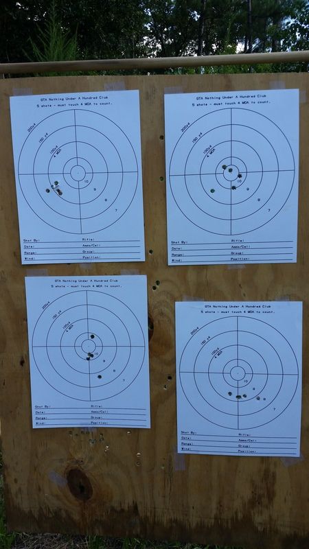

Did some testing with the new 135gr BBT's.
Making progress. I did some mods to my rifle. The barrel band only had an oring in it to hold the end of the barrel. I drilled and tapped 2 4-40 holes and put set screws in them to lock down the barrel. I also made a brass barrel weight. It can slide up and down the barrel and be locked in place with 2 set screws. The best group I got was just under 7/8" at 100yds. I ran out of air before I could do anymore tuning.
Bullets
Best group so far.
Targets as I was tuning.
Magnolia,TX
