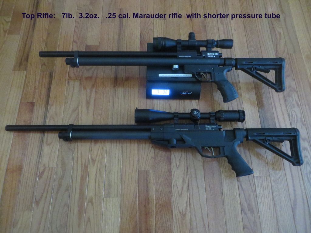

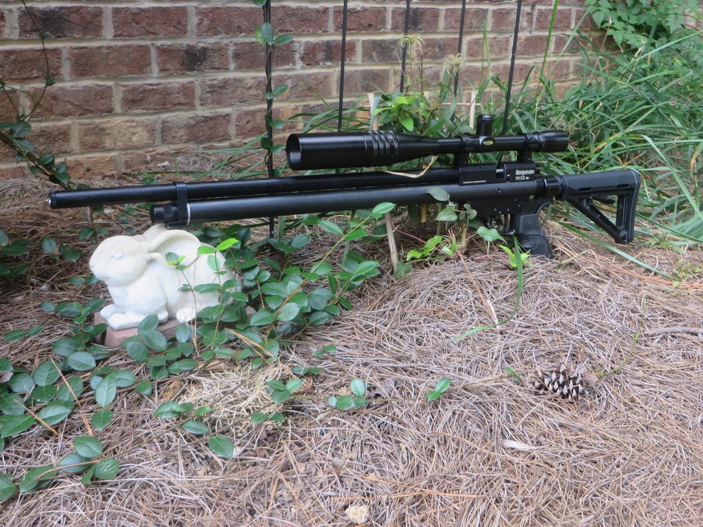

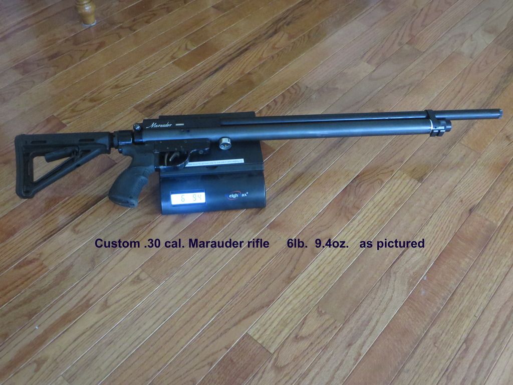

They are quite a bit of fun... I have some work to do to complete the shroud/ldc but once that is done I plan to try it against some tree rats. At full boogie, this one is capable of 13-14 shots with 70 gr cast at 1000 fps. Turned down significantly, it is *VERY* accurate with 44 gr JSB...and more shots too.cheers,Douglas
The new King Heavies seem to fly better in the wind than the 30's. It is a limited data set, but seems to follow the reports of the Heavies having a 20% better BC than the 30 cal pellets. In calm, both will bring giggles over the small groups...some of those, held to 5 shots are very small. The 25 having a BSA barrel, and the 30 packing a .590 OD, 26" twist from TJ's fitted by RTS Machining.cheers,Douglas

I have noticed the jab pellet gets moved around in moderate to high wind also, more than it should also. Be nice if H/N join the band wagon and develop a .30 cal pellet around the same weight.By the way, nice build 👍🏻 almost looks like that citrus brand moded out of Florida
Tim, What shot count did you get with the "30 cal" and the shortened air reservoir? Chris
Nice looking marauder.. light too! Do you know where I can buy that pistol grip for the marauder?
What Hammer spring weight?
