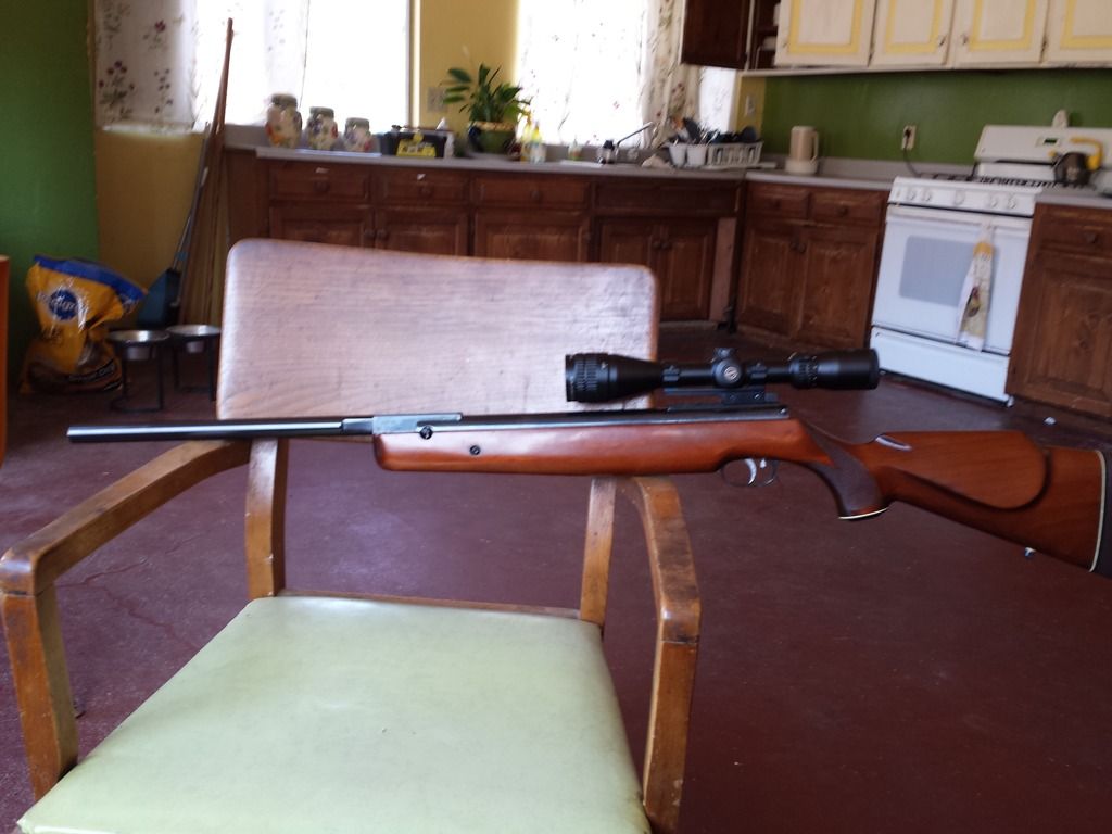

Like the title says. I have an old Beeman R10 in .20 and really like it. But I would like to switch to either a .177 or .22 so i can have more pellet options. I mainly want to shoot lead free because a California condor just moved into my area and don't want to be responsible for poisoning him. I caught him eating a dead possum in my backyard. With money tight these days I looked into just getting a new barrel instead of buying a whole new rifle. Has anybody put an R11 barrel on a R10 or R9? I'm curious how the extra barrel weight would affect how the rifle shoots.

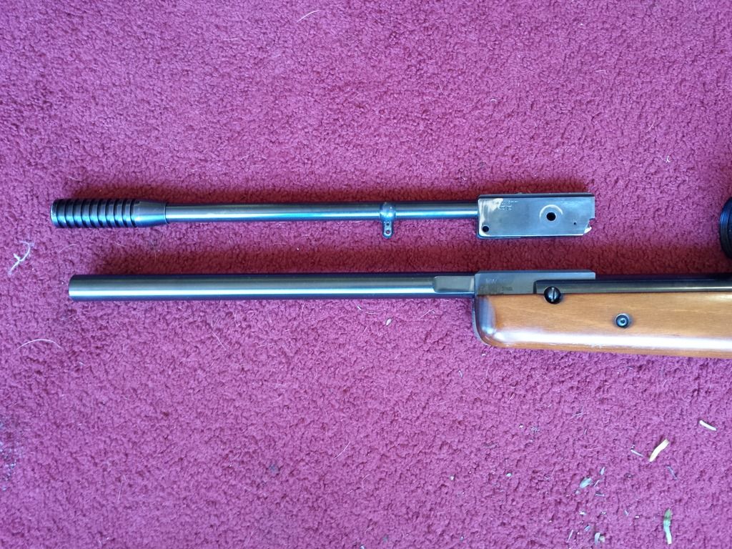

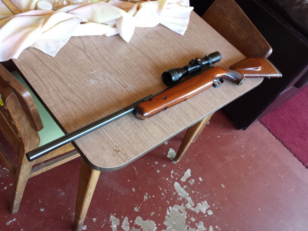

Managed to find an R11 barrel in .20 that someone never used and was willing to sell. I know I said I wanted one in .22 but I guess that's not happening right now. So I swapped it in and I really like how it looks on my R10. It does add a little weight to the gun but no big deal for taking out hunting all day. I noticed the pellets I tried with it so far have slipped into the barrel a little easier, like if the R11 barrel is a little looser than the R10. With the Beeman FTS pellets the head slips right in and the skirt fits snug. With the old barrel I would have to push the head in. So far it seems to be grouping better. Not sure if it's due to the way the pellets fit or the extra weight on the barrel. The extra weight does seem to make the rifle more stable when firing. So far I'm very happy with the swap.
