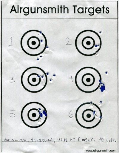

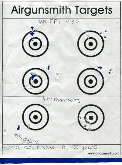

Today's pellet test is with H&N FTT 5.53 ,at 30 yards with the HW95L .22The height was off so I chased zero on the first target. Got it close and since I have no more windage adjustment in the scope I went ahead and shot the remainder of the targets. I don't think this is the pellet for the gun. My gut feeling is that it likes the head size,but wants something heavier. Of course I have to consider this might be the fault of the loose nut behind the trigger. That always a possibility ,and in my case a probability. I think I'll try an experiment to eliminate an equipment factor. I'll remove the scope mount and reverse it,mount the scope back in it and see if POI changes dramatically. If so I need to get a new scope mount. If not ,then I consider other causes,including me unconsciously jerking the trigger.
