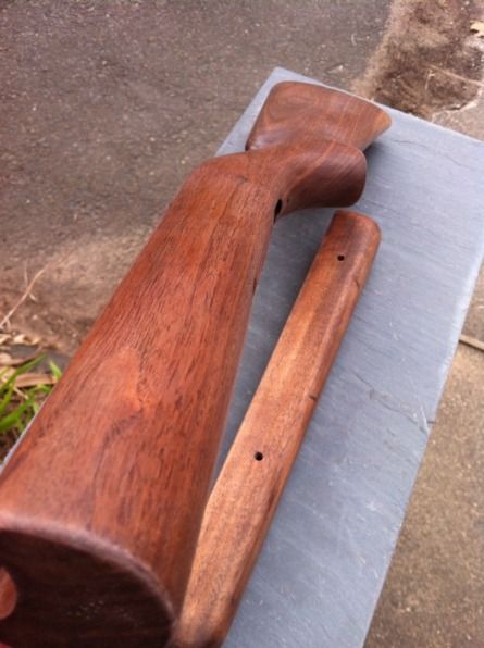

Ok i have a new Benjamin 392 bought new last year, dated march 2014. Got it through amazon and got lucky on an incredibly accurate shooter. Did the whole paint outta the barrel. Did a full disassembly to clean out and sand down any and all burrs. Did the 2 spring mod to the valve, what a huge difference that made in pumping effort and increase in fps. Replaced the roll pins with solid SS pins.
Now im currently refinish the 312's stock and when i look at the 392, its night and day. The thing has that ugly brown stain. Which hides all the grain, like a fat kid with candy. Now its in perfect condition not a scratch on it. I just got the fever to do wood work now that im working on the 312. I cant imagine it'll come out as good as the walnut stock. Also kinda want to do it cause there is really no search results on refinishing the newer 39x's.

Took the stock pad off. Can see at the edges the stain didnt get in the wood to deep. I dont understand why they didnt stain underneath the pad??? You can see it bleed threw under the pad when it was done.

Ok took some different grit sanding paper to her for a couple hours last night. Now will i need to get a stripper and get all the stain out or can i just sand it a good bit more and Tung oil it up?

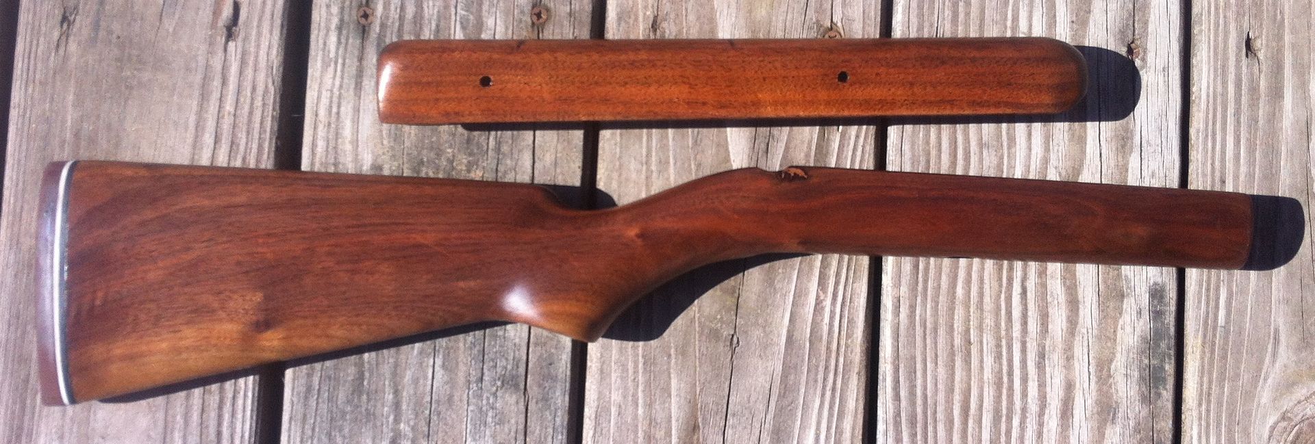

This is my 392, sanded off the old finish, reshaped the wood some, stained with brown leather dye, then used True Oil to finish. Cell phone picture does not show up real well.

Playing with wood is a good time killer. I did one session oh sanding. Ran a damp rag across her. Let it sit for a day. Sanded again and ran a damp rag across it. Now im down here about to start sanding again to be ready for stain, oil, or whatever.
Your rifle came out nice Van! Did u use a chemical stripper at all or just go to town with a bunch oh paper?

I think they are both ready for the next step. Sanded with 80, 120, 150, 220, to 3M finishing pad. Than ran a damp rag and let it sit till dry. Did this process 2 times. On the 3 sanding didnt run a damp rag across. Just cleaned it of all sanding.

Here is my 397 that I did. I sanded off all that strange color that they use. The stain I used was Dark Walnut. It shows the grain real good but it does NOT look like Walnut. I used Formbys Tung Oil High Gloss for the top coat.

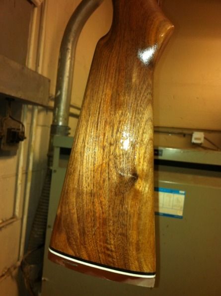

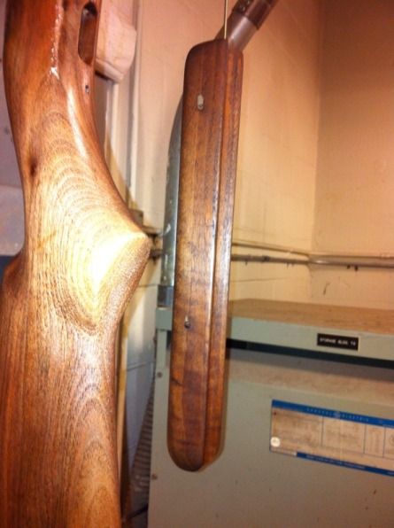

Here is my fore stock after the run down of sand paper grits stopping at 220. Then starting with the steel wool 0 and ending with 0000. It leaves the wood with the feel of polished granite, its that smooth.
here is some close ups to see the grain and wood pores.
Here is the butt. I did a little re shaping here.
Here is both, notice the mis match quite common on these rifles.
I stained the fore stock to closer match the butt.
Here is after 1 then 2 then 3 then 4 then 5 coats...
Steel wooled down to wood and Third coat applied.
here is after 5 coat.
Here is steel wooled again and the sixth coat
Lastly here we are after the sixth coat.
After a couple days I knocked the sheen down with WD40 soalked on a 0000 wool pad.
