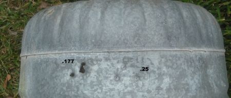

12 fpe comparison:1 .177 shoots flatter than .222 .22 is more efficient than .1773 .177 will usually penetrate more than the .22. So pass thru is easier depending on target, pellet and penetration thru sheet metal or something similar will be higher for the .177. This is true for most situations but there always seems to be one or two exceptions.
Quote from: LDP on March 07, 2015, 09:29:02 PM12 fpe comparison:1 .177 shoots flatter than .222 .22 is more efficient than .1773 .177 will usually penetrate more than the .22. So pass thru is easier depending on target, pellet and penetration thru sheet metal or something similar will be higher for the .177. This is true for most situations but there always seems to be one or two exceptions.How do you measure this?
