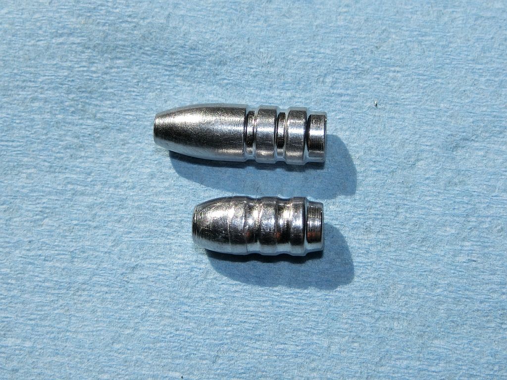

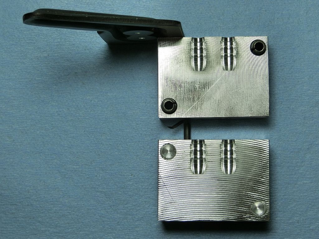

A few quick pics BOB of the 7mm BBT 95 gr LBT mold:
Some of the bullets from the BBT mold:

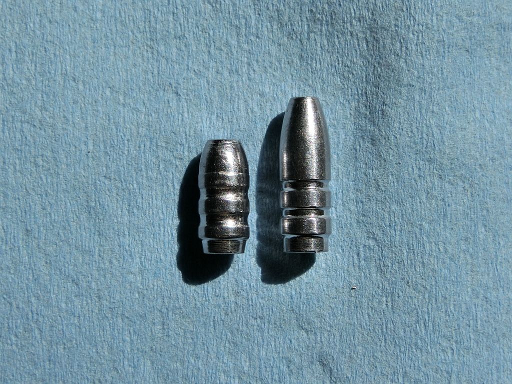

The bullets look good but the smooth lube grooves have me wondering if its my pots LOW TEMP or the mold is just that way. A LBT 130 gr FP picture was taken next to the BBT bullet for comparison. Regardless thought, only shooting will tell. Im going to test them out tomorrow.

Cedric, it's more than likely the mold temp rather than the pot temp, Folks try to cover up Way too much casting issues by turning up the heat. It's usually only a crutch to cover up something else that is wrong.

I will try and heat the mold up more during the casting process and see if i can get some defined lines of the bullets. I don't know though, the lines are hard to see in the mold and i'm casting no different than i usually do.
But again, i will retry everything all over with casting.
