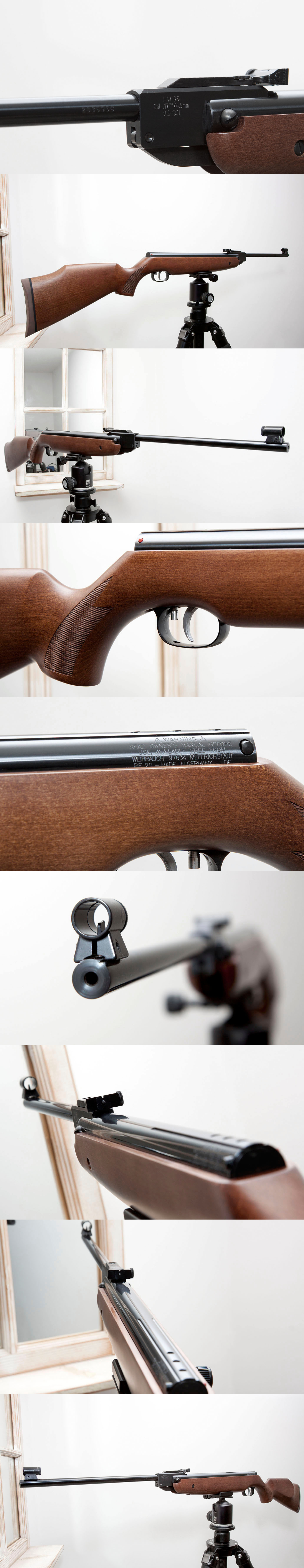

Thank You,I am a photographer so I thank you on both fonts. :-).Its almost ready for a return trip from a full tune by John In PA. She is nice looking, grouped very well, but twanged like the dickens!I spoke with him about it and he says some come from Weihrach with just a little, and some come twanging to beat the band.Mine is a band beater.She is getting the works. He updated me yesterday saying the piston buttoning was done and she is moving forward in the process.The next time you see her a Vortex Diamond Back 4-12-AO will mounted.
