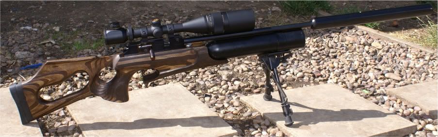

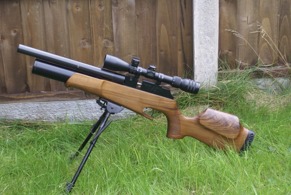

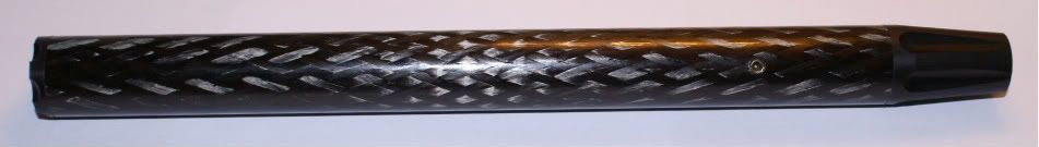

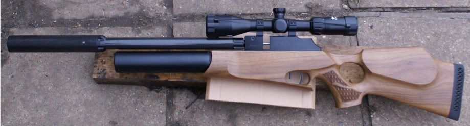

Yes I do exist , lol .I`m not a shop just a hobby airgunner , Made a few ldc`s / shrouds (can call them the "s" word in England
) for myself and few mates on a theoben rapid forum I run . I don`t really sell them just make an odd one here n there . No one passes on my details as just do them for friends , Havn`t got time to make loads .

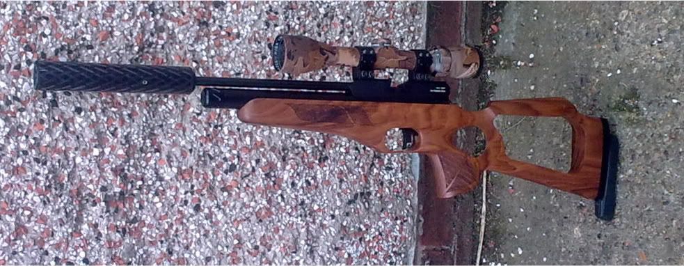

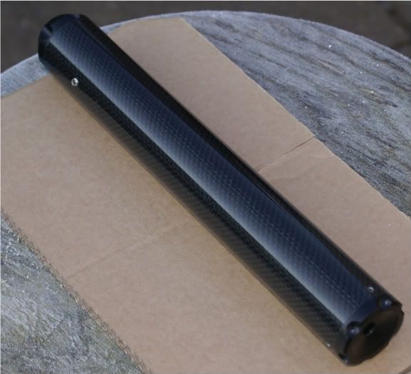

Heres a few pics of some shrouds Ive made

Now that's some serious hardware.
Those are some fine looking shooters ns!

At the risk of sounding like a perv, you sir, have some nice cans. Workmanship looks to be excellent. I like the style of your endcaps. Are they anodized aluminum/aluminium? I'm really starting to like the looks of the carbon fiber tubes.
Nice airguns, too. I especially like the 4th pic from bottom. Looks like a very handy hunting carbine.
Welcome to the forum and thanks for clearing up the mystery. It's too bad you are limited production, because you are an artist.

The end caps I make out of delrin which is a machineable plastic . Machines nice and is already black . I will be doing a few with ally endcaps in the future but there is no real benefit over delrin for those parts . Need to finish doing my anodising tank so that I can anodise and colour the aluminium then I can use ally for the tube too which is a lot cheaper than carbon .
Got to say though carbon is awesome stuff to make shrouds from . Its extreamly true and looks very nice just not cheap to buy .
The little carbine is a theoben mfr . normaly they have a 16" barrel but I cut this one down to 8" and made the carbon shroud . Its a great little hunter to use out of a 4x4 and hasn`t lost any accuracy from the barrel chop . Total length is shorter than a crossman 2250 .

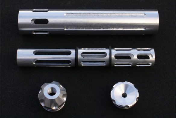

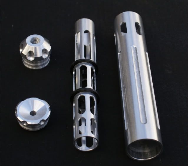

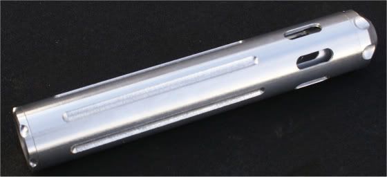

Heres an aluminium 1/2" screw on LDC Ive been making . Still in the white but I`m going to shotblast it and anodize it black next weekend . The slots cut into the tube are going to be filled with stainless steel mesh and there is some wadding to go inside too .
Will put another pic up when its finished .

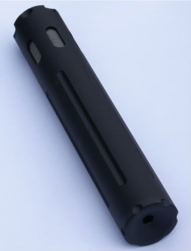

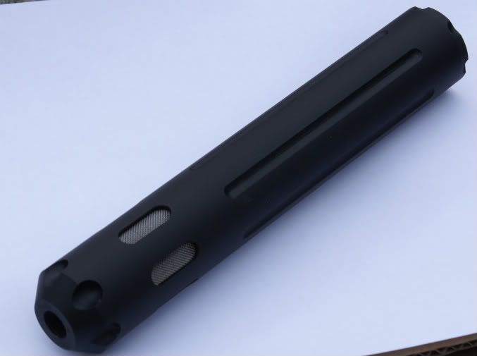

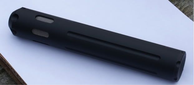

All finished , shot blasted and anodised
Nick

Now that is some exceptional work my friend. Welcome to the gta and keep posting the beautiful work
