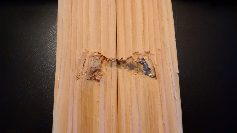

I'm going to add a weighted insert to the hammer first to increase the valve dwell time before I take the top end apart and try the oblong port.
Here's a WM shot into a 2x4 from 7' away...it penetrated the same amount as my Challenger did at over 1000 fps so I believe that's the slugs maximum penetration amount in a 2x4 due to massive distortion.
That slug is *smashed*
Mike

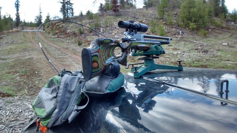

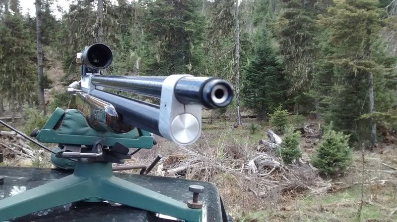

Well, my Wicked Monsters proved to be most accurate in this rifle too...my 1:22 twist just loves them!
I didn't shoot any Kings as I wanted to leave her tuned hot for hunting (pics in the Hunting Gate shortly).
I cleaned the barrel by pulling a .257 Bore Snake with the brush removed through it twice.
Then I saturated 2 felt cleaning pellets with Brownells Moly Bore Paste, loaded them, fired them then shot 2 Kings down the bore to clean things up.
It took about 8 shots to settle in but it sure made a difference!
Here's a three shot group @ 30 yards from the hood of my Jeep using a fixed 6x Bug Buster scope. The rifle was tethered via remote line to a 13ci bottle regged at 1800 psi.
That guard rail up the road was about 75 yards away...the holdover was the bottom of the first dot below.the crosshairs...I was *slaying* a Red Bull can every shot!
I will try to run some shot strings when I can...the law enforcement range has been closed for the last 2 days so they can burn their slash piles.
More to come!

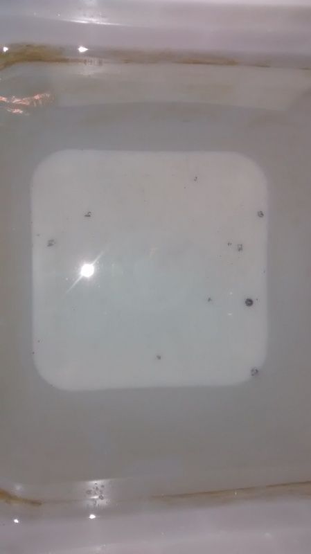

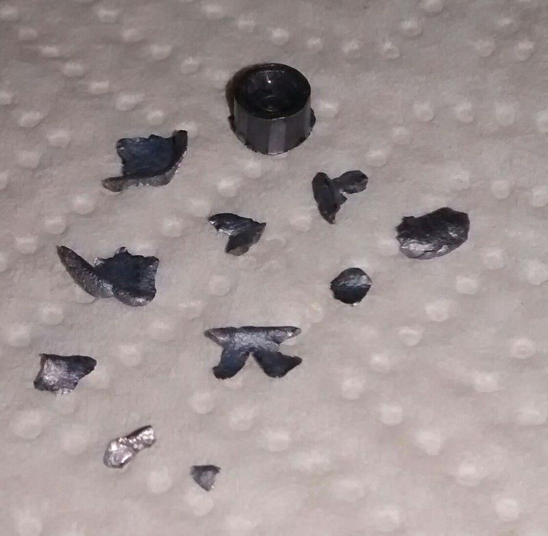

So, tonight I turned a hammer spring guide out of 316 stainless round bar to add weight to the hammer.
The hammer, guide & stainless cocking knob weigh 79.8 grams.
I had to go to a 1.5" x 12# spring vs the 2" x 10# spring I was using because my guide fills the pocket inside the hammer and is flush with the rear.
All I could do tonight is some unscientific testing...which was shoot a Wicked Monster into my water bucket and see if I got more expansion which means I got more velocity.
I filled the rifle to 1800 psi and had the RVA set just shy of coil bind.
When I shot into the bucket there was valve ping! That hadn't happened before...curious I had to go check the bucket for expansion of my slug.
Prior testing at 850 fps got good expansion but only a few fragmenting pieces.
I have *no idea* what the velocity is right now but I will let the pic of the slug inside my bucket speak for itself - its more violent than my Challenger testing & that was just over 1000 fps!!!
It may be just that one slug and how it hit but there's a big improvement...I'll be running chrony strings tomorrow.
If I'm at where I think I am performance wise I am done tuning and will start assembling powerplants on the rest of the guns.
Here's a pic of all the pieces I recovered from the bucket
More to come tomorrow!!!

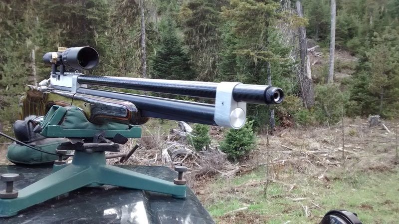

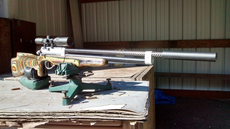

I got to do a bit of chrony work today...I settled on my original hammer/spring combo.
This is a 30 shot group with Kings @ 25 yards - anywhere from 978 fps down to 820 fps. Fill pressure was either 1800 or 2200 psi.
The 5 shot group to the upper right side is how far my POI moved just from screwing on my Clague LDC! I took it off after.
WM's @ 855 fps - RVA -2.5 turns - 50 yards
My 50 yard target...the upper target lower right side group was with my Clague LDC. I took it off and shot the .600" 5 shot group to the lower left of the bottom target (even though I was aiming at the top target LOL).
The other shots on the left of the upper target was me getting zeroed for 50 yards. The 2 shots in the bull were my final sight in shots. Not bad for a small/6x scope
Air usage went from 400 psi per shot with the 80 gram hammer & 12# spring down to 200 psi with the RVA backed of 2.5 turns and the 10# spring with the spring guide removed from the hammer.
I'm definitely happy! The barrels aren't even bonded yet...the cf tube is just locked into the barrel bands with the barrel floating freely inside. The muzzle is o ringed between the barrel and cf tube for centering and the thread protector is putting tension on the cf tube.
Worth noting...the velocity of the kings stayed the same from coil bind to -5 turns out on the RVA. Air usage dropped from 250 psi per shot down to 175 psi per shot yet the velocity remained at 905 fps.
I need to play more with a pellet tune. My WM's were doing 790 fps with the RVA @ -5 turns and using only 150 psi per shot.
More to come guys!!! I'm at the machine shop tomorrow getting all of the barrels prepped and threaded...I have 14 to do!!!
