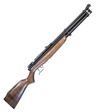

Where did Lloyd get the idea for the Disco Double? Is the Benjamin Discovery somehow deficient in air capacity? Not really. But Lloyd was building a special .25-caliber conversion of the rifle for a customer, and it ran out of air very fast. The double air tubes were put there to make that big .25 a workable solution. And, after seeing what those tubes added to the rifle, Lloyd naturally expanded his conversions to the basic rifle, and the Disco Double was born!
... it only works as a Reverse Pumper...the pump arm pivots reverse to what everybody is used to.I will take a better look at that design later...I have an idea that will allow us to get away from the reverse pump configuration.
... possible to incorporate a regulator into the front plug of the upper tube.... That would leave the lower tube as the reservoir and the upper as the plenum, which makes sense as the valve is already mounted in it....
.... C'mon Lloyd, join the party?....
It's not a simple thing to tool up to make the required internal regulator housing (the only way to do it, IMO)....
