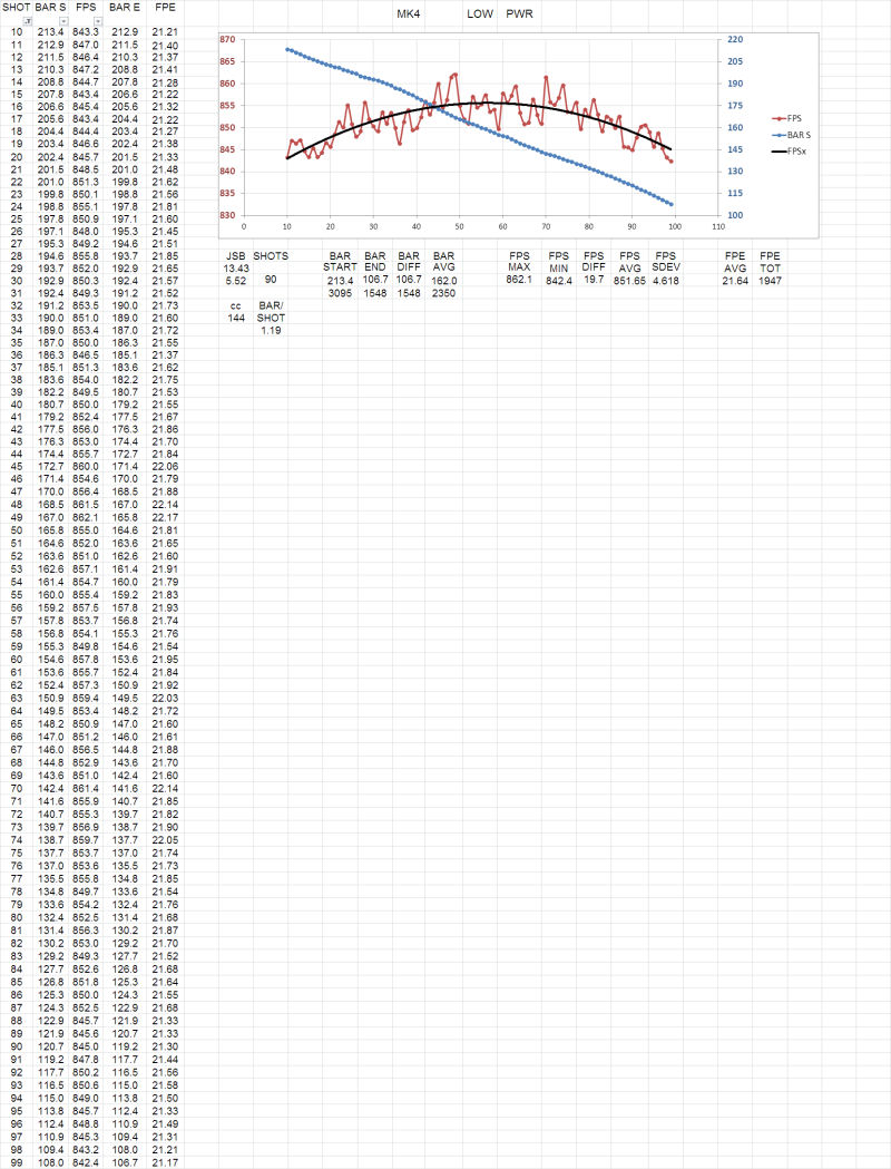

Grobe - I will post my data, but I shot at my parents house and forgot to bring the spreadsheet back with me. Should be able to get it tomorrow.

New Daystate MK4 DATA
October 13, 2014, 09:22:38 PM »
XL spreadsheet of MK4 chrony, pressure and fps data.

October 13, 2014, 09:42:24 PM »
thanks for posting.

October 14, 2014, 03:11:36 PM »
Grobe,
I wanted to post a screenshot of my graph and data so everybody could see it without having to download the actual file and open in in Excel but my screen shot was always too big to attach to the post. Do you know how to do this?

October 14, 2014, 03:57:48 PM »
A GIF format will generally compress software screenshots well to stay under the forum's 200kB limit, and do so losslessly (without artifacts).
JPG is better for natural images with broad color depth and gradients but tends to develop artifacts. The amount of compression can be adjusted, however, to meet some compromise between quality and file size.
Lots of programs can save to both formats but I like Irfanview. Simple yet versatile and always free, just pay attention during installation and uncheck the optional software (a browser toolbar if memory serves).

If I read the numbers correctly (144 cc, 106.7 bar drop = 937 CI) and (90 shots @ 21.64 FPE avg = 1947 FPE total) that works out to 1948 / 937 = 2.08 FPE/CI, which is flat out remarkable efficiency !!!
