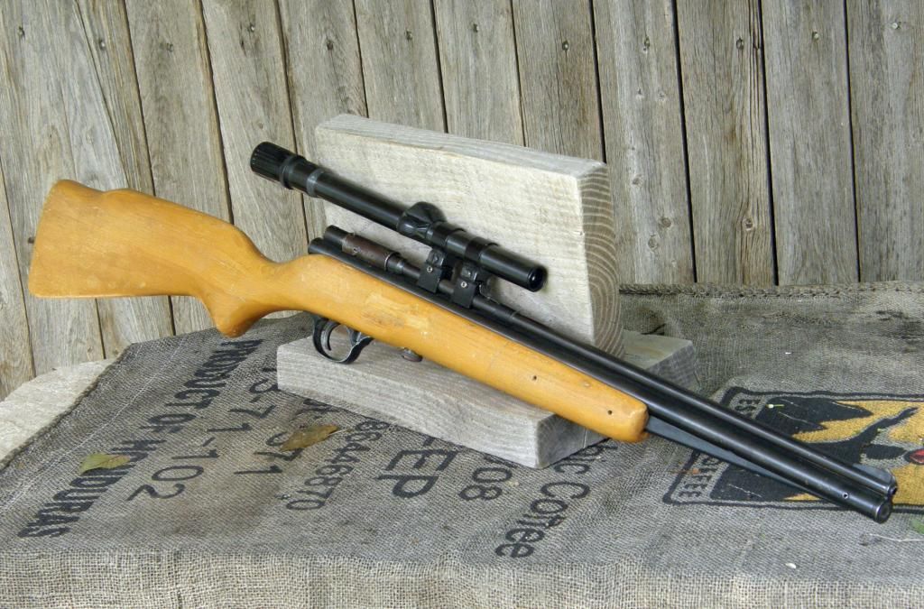

The forearm on my 342 does not stay up. From what I understand there is a spring that keeps this from happening. I guess mine broke. Can anyone tell me how to fix that?

I just ordered one for a Benjamin 310 from Bryan and associates. It may be the same as the 342? Give them a call I'm pretty sure they will have them.

Look on the bottom your lever. There is a little square hole. It should have a spring anchored there. Even if is there it could be broken. If the seals are bad, that will also make the lever droop.
We have the lever springs. cost is $7 plus $3 shipping. You can find us on the GTA Mall Dennis Baker Baker Airguns
