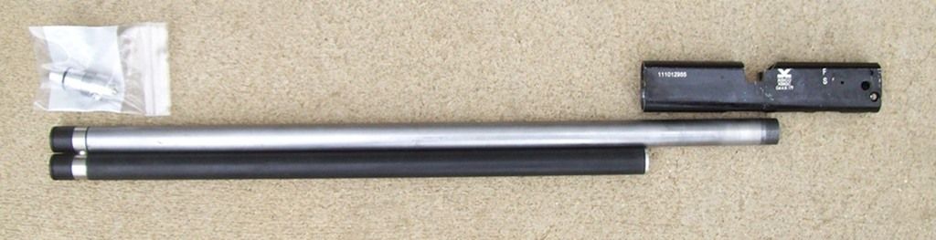

Mike,All of the double tube kits have at least a 3 to 1 safety factor at 3000 psi, so yes, the "kit" is plenty safe. That includes the tube, the threaded fittings, and all the other hardware pieces included in the kit. However, the Benjamin Discovery air rifle, from the factory, is only rated to 2000 psi, so it should not be filled above the factory recommendation. That said, with proper modification of the factory tube and the valve body to use three 10-32x3/16 high strength alloy steel low profile socket head cap screws, the security of the valve body is improved. With that modification done, filling above the factory recommended pressure is still a personal decision. Just for reference, both the Marauder rifle and pistol are rated at 3000 psi from the factory.Lloyd

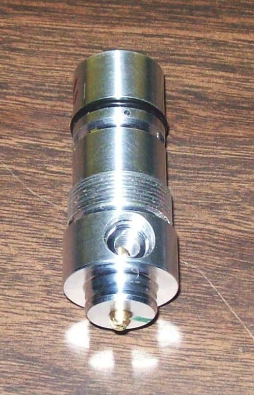

Yes, folks, that's an adjustable regulator.... A little surprise I have been working on behind the scenes with Eric and Lloyd.... It is installed inside the front plug for the upper tube....Bob
IIRC, about 500-2200 psi, I can't remember what Lloyd ended up with for a final range of adjustment.... The entire upper tube ends up at the output pressure, so it is suitable for lots of power if required.... Bin
Quote from: rsterne on May 13, 2016, 10:35:09 PMIIRC, about 500-2200 psi, I can't remember what Lloyd ended up with for a final range of adjustment.... The entire upper tube ends up at the output pressure, so it is suitable for lots of power if required.... BinWow!Stalwart, put me down for one now.
Quote from: rsterne on May 13, 2016, 10:21:20 PMYes, folks, that's an adjustable regulator.... A little surprise I have been working on behind the scenes with Eric and Lloyd.... It is installed inside the front plug for the upper tube....BobAs a matter of fact, this was Bob's idea. A good one... as usual.
I might have just soiled myself... Will this be an option for all double-tube kits, across supported platforms?
Sorry, I couldn't remember what the upper limit was on the setpoint.... 2700 it is.... *LOL*.... Nice to see this project come to fruition.... *grin*....Bob
