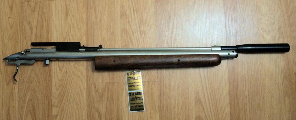

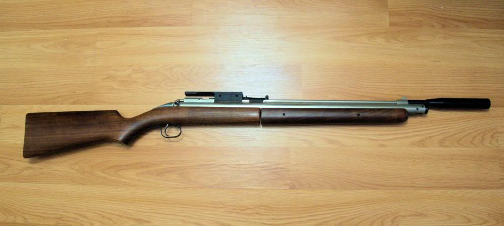

That looks really cool DD789. Is it now a Steroid? And what is the significance of the extended shroud? Either way it looks pretty bad @@@.
