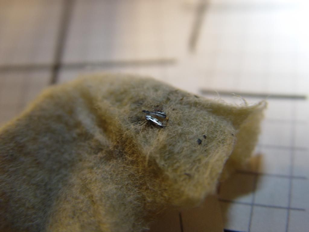

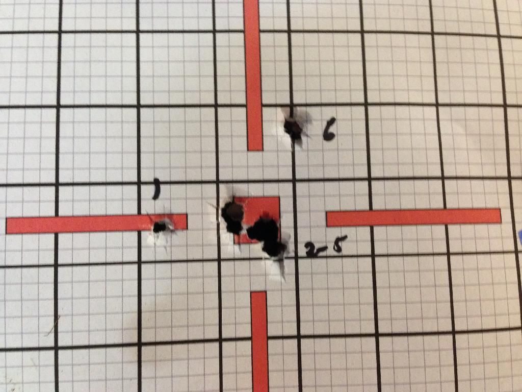

well it's trying my patience cooler today but little to no wind. Groups were bigger and I had more fliers.....looked at the barrel and it was leading pretty good, so I decided to clean it, this is what I found:Mind you this is the second patch through, the first had even more on it but was so dark I couldn't get a clear picture, those are lead shavings. I had found them on the previous cleaning and rounded the edge of the port inside the barrel, apparently I either didn't do it enough or there is someplace else shaving the pellets. I rounded the port some more and polished the heck out to the leade in. I then ran several patches with grit from my fire lap kit, med. then fine and finished with JB - much smoother and shiner - we'll see if it stays that way.
