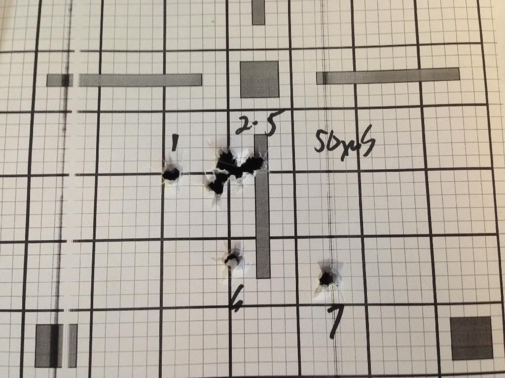

Quote from: dogwood on March 13, 2014, 10:16:58 PMI'm leaning that way as well, thinking of ordering a 24" TJ in .357 LWs work also well, some local lads are getting 15mm ctc groups at 60 yards using bullets. My stock barrel does 4mm ctc at 20 yards with JSBs and 8mm ctc with roundballs. I think I'll have to work with the barrel next.
Quote from: rkr on March 14, 2014, 02:14:23 AMQuote from: dogwood on March 13, 2014, 10:16:58 PMI'm leaning that way as well, thinking of ordering a 24" TJ in .357 LWs work also well, some local lads are getting 15mm ctc groups at 60 yards using bullets. My stock barrel does 4mm ctc at 20 yards with JSBs and 8mm ctc with roundballs. I think I'll have to work with the barrel next.That's good to heat rkr, the LWs are .356 are they not?
Maybe your barrel is vibrating , maybe your barrel band needs pressure applied or less pressure. I use the barrel band as the final adjustment when zeroing on my WC. With scope if it hits high/low/right/left on a 1" target at 50y I use barrel band set screws if need be to make it hit dead center if scope will not . Just a suggestion , works for me maybe this can help your groups
