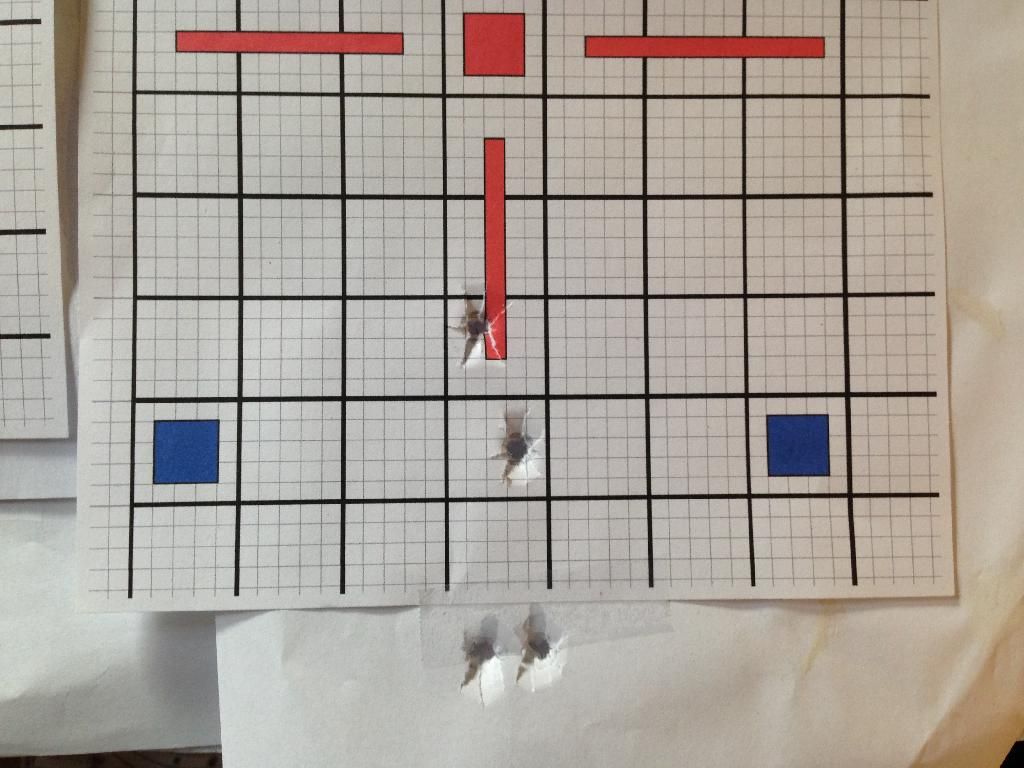

I assume that you have checked that all the pieces in your scope mounts are tight. The shot string doesn't explain that 3" up and down movement. I also doubt that free floating the barrel would do that, although you could stuff one big o-ring in between the band and the barrel to make it semi-floating and see what happens.BTW, after being a pump guy for 5 years I finally gave up and got tanks with my 9mm Blizzard. It just takes way too long to fill one up when you let the pump cool down and all that trouble for just 5-10 shots.
I believe Manny is right about hold technic with big bores, why, because I also had a problem just like you. Rounds all over, then would group a clip or so then all over again just like your pics.What I found out in the end on my Windy City was it was suffering from excessive barrel vibration most likely because I had it putting out 127fpe which is hard to do vs a rainstorm . What I did was: 1. Make sure barrel/bottle band was not putting any pressure on barrel and tight screws carefully . 2. Put thin low recoil rubber between bottle and shroud. 3. Placed two o-rings on barrel between it and shroud. 4. Made sure to rest riffle at its balance point or held at its balance point on bags with butt planted in shoulder. From there it started making one big ragged hole at 50y.Must say, befor I came to a understanding of what was going on, I went thru 600 JSB, sent the hawk scope back for warranty work (nothing) wrong with it order a leapers, bugged W. Piatt and cried the blues . Everything's fine now, so hopefully one of those things will help you just remember in ways hold technic on big bores is just plain different from little bores good luck.

I'll say this again,Sumatras, Sam Yangs and Carreres have the barrel stuck to the airtube and they are suberbly accurate,other videos of Sniper Tactical show good accuracy, I think you are just chasing ghosts
