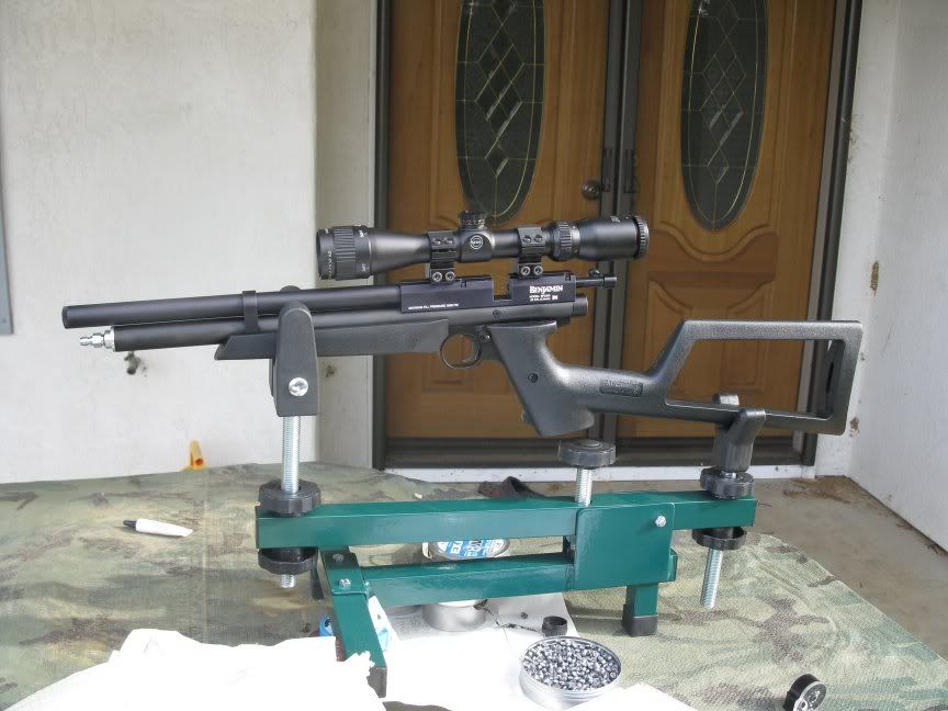

I think I posted these numbers elsewhere. I have just returned from a business trip that curtailed further shooting. So far, I have about 50 pellets through the thing. I dumped the pistol scope in favor of an unemployed Hawke (much better).
Everything was great (especially trigger), except accuracy results so far. I did have unexplained fliers with the JSBs at 25 yards. It is certainly not as quiet as the Marauder rifle, but not loud, either. I have compared it to the 1377 at 4-5 pumps.
CPHPs, a couple ERRs and one double load threw my stats off. Aired to 3000 psi for each pellet type, shot down to just under 2000. Settings are out-of-the-box from the factory, no mods at all.

Consistency is excellent, making the fliers harder to understand. It will be time to check the crown and muzzle of the shroud for any sign of clipping. Of course, more and different pellets may also be the cure.
The opening at the end of the muzzle is set up for a .25" hex. This does not leave much margin for error with a .22 pellet. A little bit of yaw on exit could cause some clipping... details to follow.

Dave I fortunately have not had the flyer's in my group's with all 8 slight stringing up an down(my hold I guess), sound's like your mag though is doing like mine an getting a double feed now an then? Also if your shroud is like mine was you can "hand" unscrew it,muzzle an breech end were not real tight on it.

The shroud on mine was tightened down pretty hard. Maybe part of the problem? Hard to say with this little trigger time. No way was it coming off by hand.
Yep, I double-fed twice. It might have been after changing mags, or maybe there is a sticky chamber. I really don't remember, because I was in a great hurry to get some mileage on it before departure. When it happened with the JSB Express, I saw both pellets strike the target together.

Maybe Dave? Mine was for sure just hand tight( I went an undid it for the barrel length above), when you do get it undone keep a eye on the o-ring that set's in front of the break an shroud end cap as it like's to fall off/out when removing shroud(do not know if the rifle has this in them?). OH, just a caution Bro., but on my third double feed when I pulled the trigger no shot sounded? Took the gun in used a .22 sized wood dowel to knock them out an the rear pellet had struck the lead one with enough force to imbed in the skirt "completely" even the second's skirt was a seperate ring pushed out with the pellet's. It was very surprising to say the least(a first for me, air an powder). No damage done that I could "feel" pushing a pellet by hand(Otis wire/cable bullet tap)? But I know from now on it's "mag out" an try to close bolt if no go, wood dowel or Otis!!!

I would say yes also from the little power testing I have done,not an XL's power but still a solid 650 to 700 fps gun using 14.3 CPHP's. Mine after a light cleaning(very clean bore from factory) scoped right in an has produced 8 shot vertical string's all in 1/2" to 5/8" at 20 yd's,sure the stringing is me ,an keep's them in the 9 ring(or at least breaking it LOL) at 30yd's. All this is from a tri-pod rest using a pistol scope. Trigger is fantastic on them, all I've done is shorten first stage some on mine.
