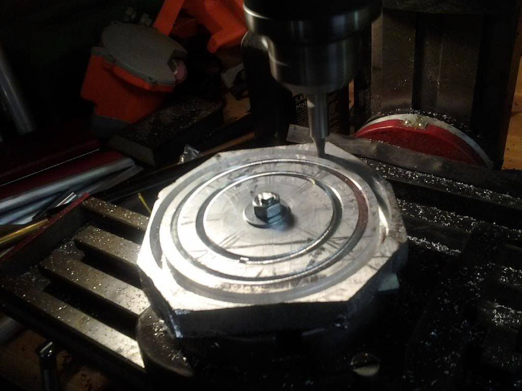

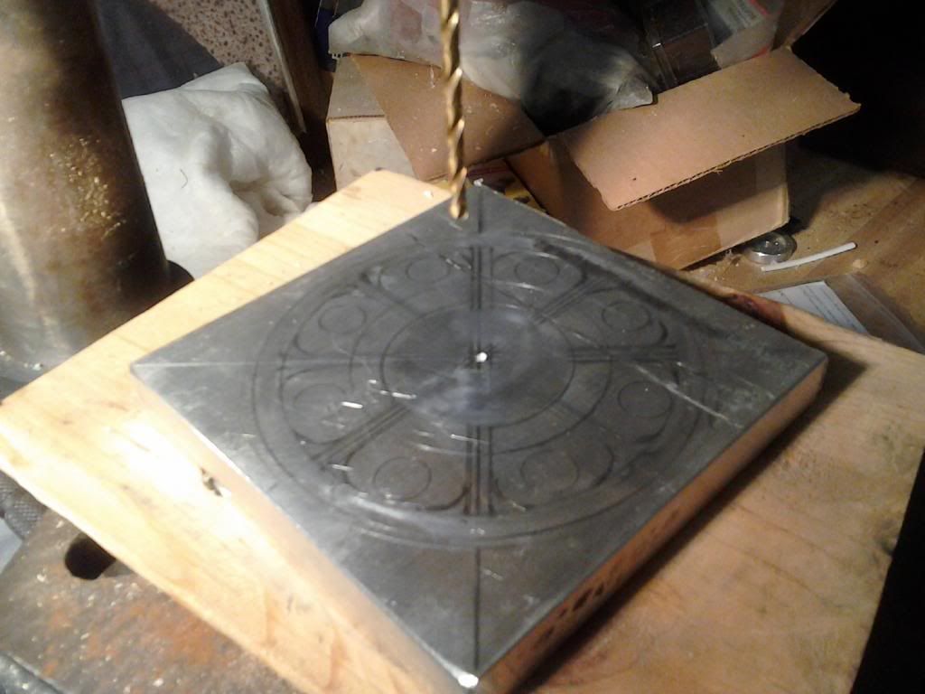

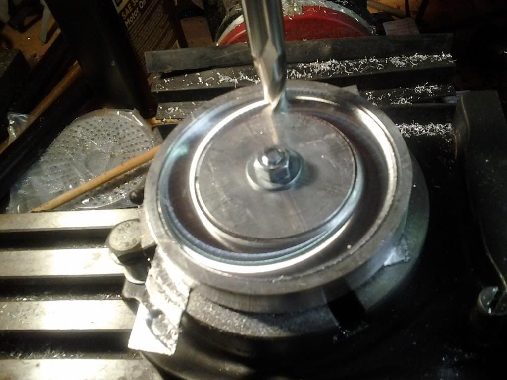

I have T nuts and a set of clamps on the way. But I could not wait. I used what brackets and bolts I had to attached the table solidly. Since I had no T nuts and clamps, I decided to just run a carriage bolt up through the center of the table and attach the aluminum stock that way. The center hole of the rotating table is a Morse taper, I think MT2, so I cut a piece of aluminum bar stock, tapered it and center drilled a hole that the carriage bolt just fit through. This is a sleeve that centers the carriage bolt. I center punched and drilled the 4x4 piece of 1/2 aluminum I had drawn a pattern onto.
I cut the hole in the aluminum a bit too large and had to also make a sleeve to center the carriage bolt in the piece before bolting it down to the rotating table.
I started by roughly cutting the outer wheel and the outside part of the hub.
After slowly cutting away to get the outer wheel, I started taking out some of the material between the outside of the hub to the inside of the outer ring.
The wheel will be approximately 3-3/4" outside diameter and I'm just going to play as I go and design as I go. I'm not sure how it will wind up eventually, but the process is REALLY fun. It's darn good therapy for me too!!!!

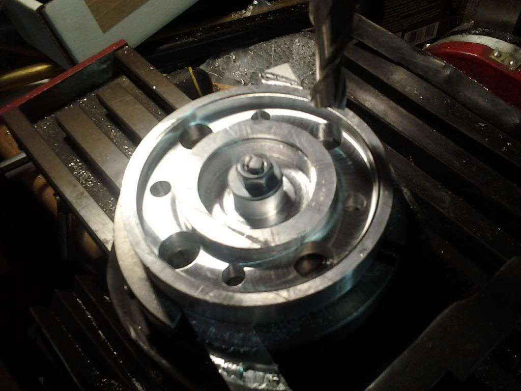

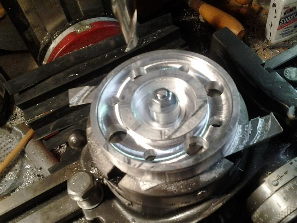

Got a tad more bench time this evening. Wish I was still down there making metal chips.
Doggeed out most of the cavity for the hub.
Trimmed out a bit of the extra and bored two differnt size holes just to experiment.
Still got a ways to go. Need to take off a bit more in the spoke area. Then I may play with designs some. LittleMachineShop is pretty quick shippping so my clamp set should be here tomorrow or Thursday. I can then clamp the wheel down and remove the bolt to finish cleaning out the hub cavity. But bolted down I can still work the surface and outside of the wheel.
More to come!!!

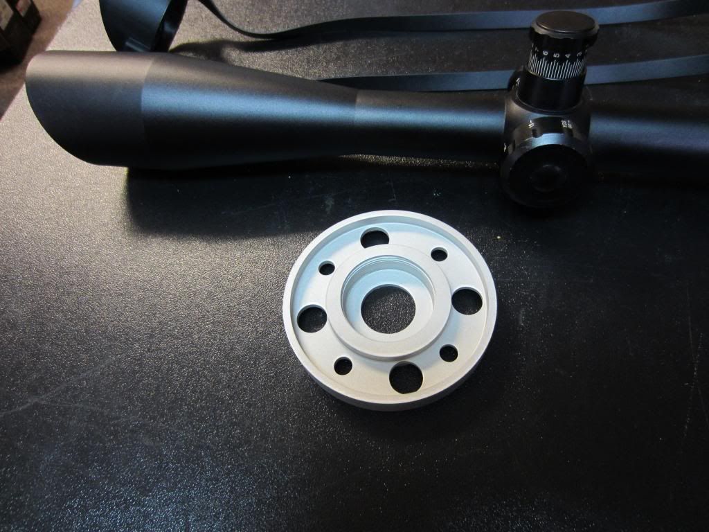

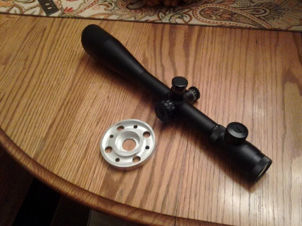

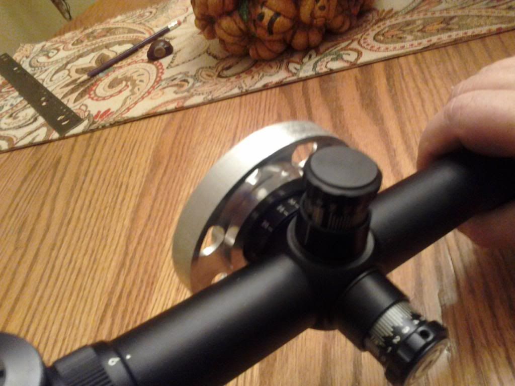

LittleMachineShop.com is really quick to serve. LOL

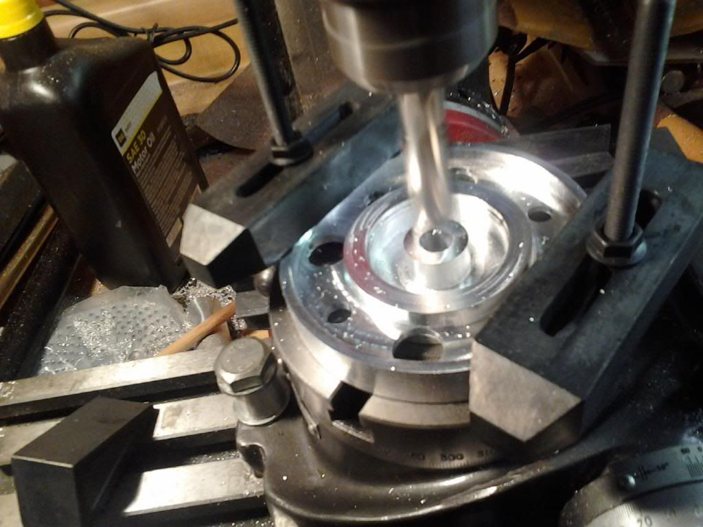

Got my clamps in today so of course I had to open the package and try them out.
Flipped the wheel over and bolted it back down first. Took out some of the spoke area from the back side to kind of center it.
Then flipped back over and attached with my new clamps to finish cleaning out the cavity for the side wheel knob.

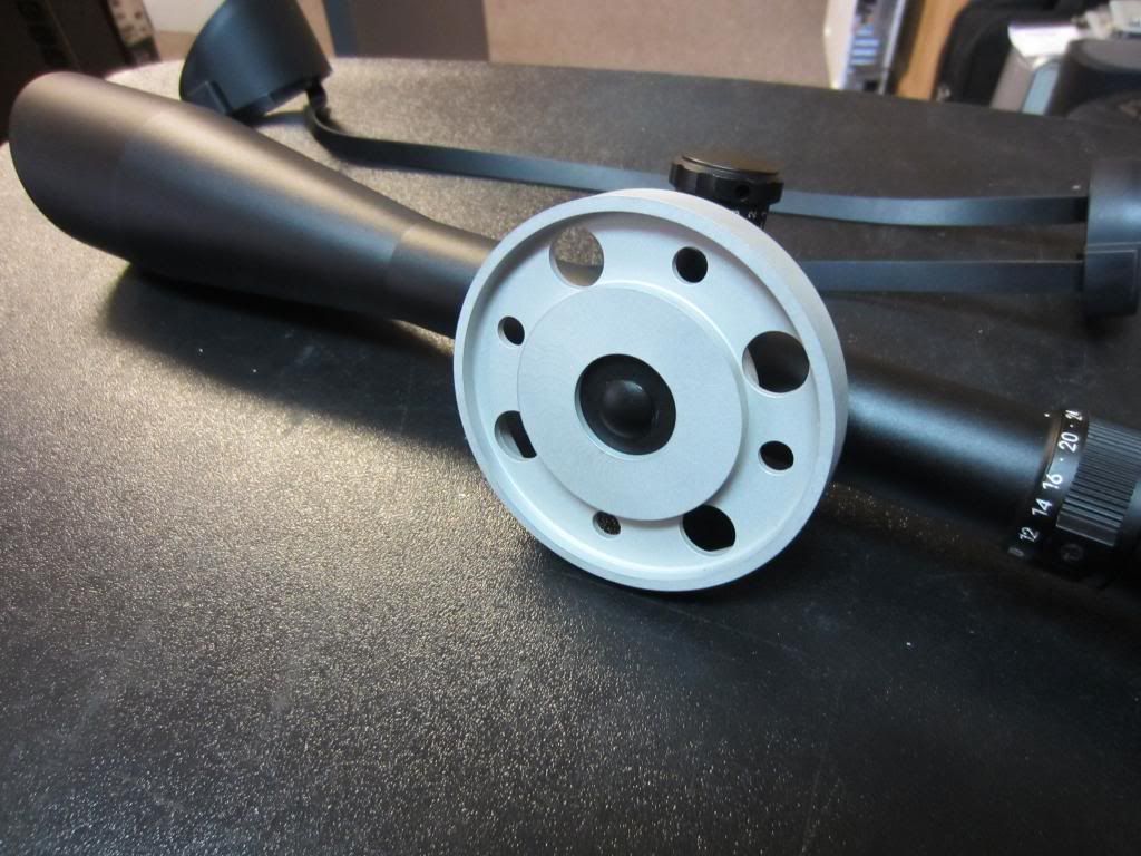

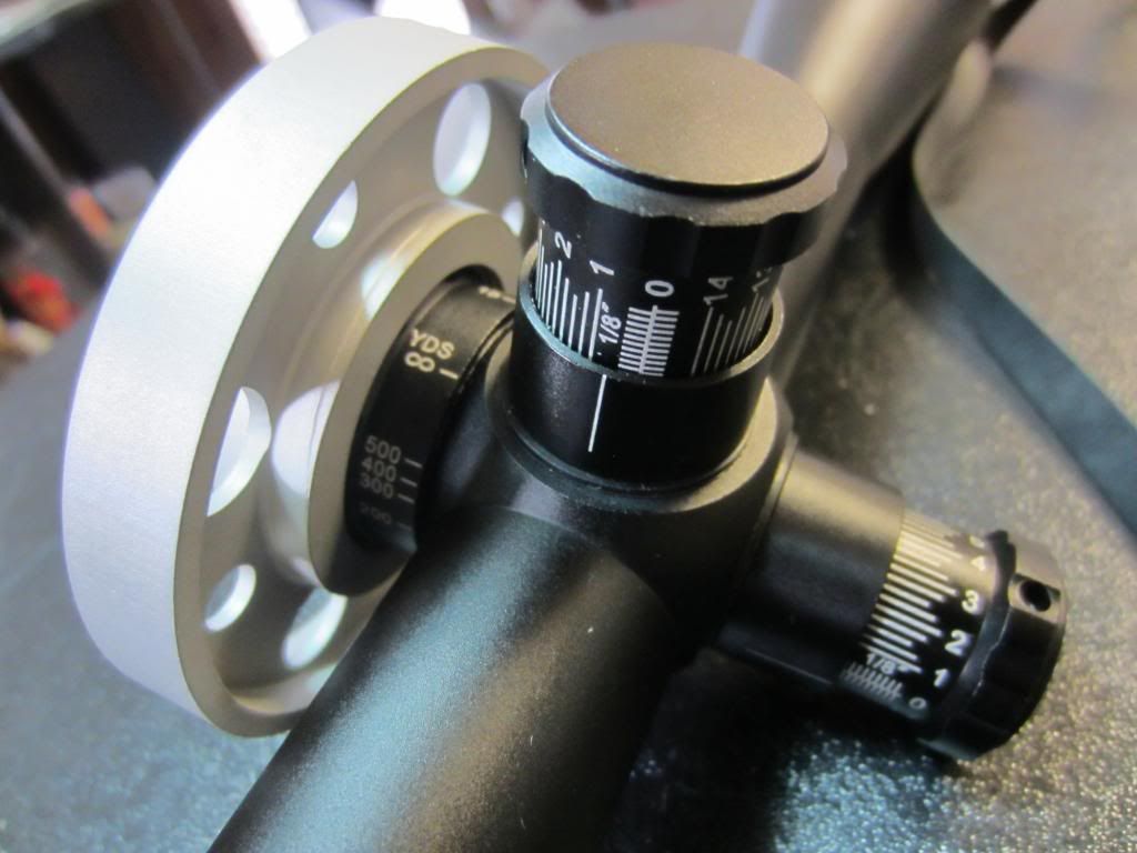

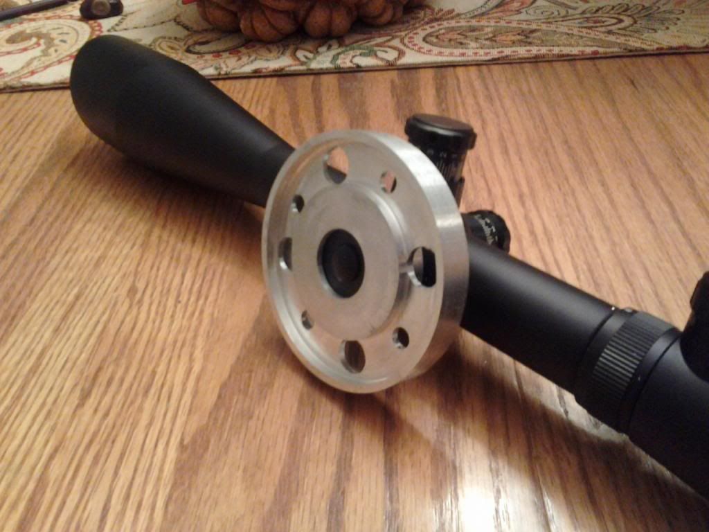

I went over the entire surface to flatten and level everything up. Here it is in white next to it's soon to be new home.
Dry fit....better than I expected for a first try.
Now gonna look at it for a spell and let my mind wander, as it usually.....er...was I through???
Anyway, I'll trim off a little here and a little there until I'm happy with the way it looks. Then mount it in my drill press, drill and tap a couple of set screw holes, followed by a good sand job then a coat or three of flat black. While I'm thinking about it, anybody see something that will give me ideas for tweaking it?

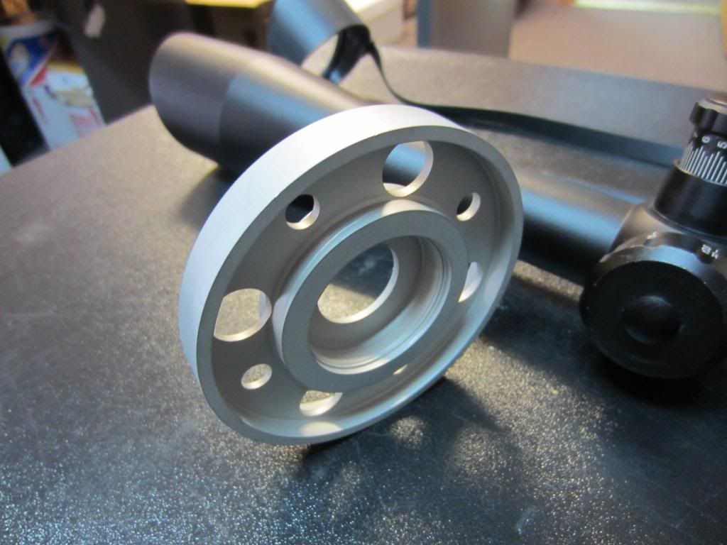

Hmmm...latest development.

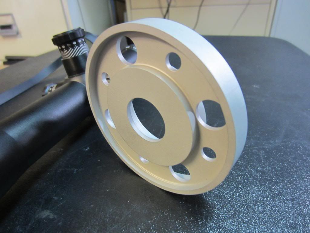

I took the wheel out to our shop (motorpool) guys here at work. Asked him what media he had in the blaster cabinet. He has glass beads. I handed him the wheel and he said he could make it look nice. Okay, I can always buff it out if it's not what I want. So into the cabinet it went. After about 90 seconds, this is what came out.
Me likie!!!
I may just leave it as is (after tapping set screws) and if anything, buff certain parts, like the rim, to give it a shiny/flat contrast appearance. Whatcha think???

Re: Making of a side wheel
October 10, 2013, 06:23:05 PM »
Looks superb!

Norm_m
Posts: 2942
Real Name: Norm
October 10, 2013, 09:03:26 PM »
Hey D EZ are you sure you have not done a little maching before! I think it looks great and it shows true craftsman ship

aack73
Nitrogen is the way to go :)
Posts: 4586
Real Name: Chad
October 10, 2013, 09:32:44 PM »
the minor polishing would probably look nice too. but it looks good as is.
michaelthomas
Posts: 1150
Reply #19 on:
October 10, 2013, 10:45:08 PM »
I'd say......either way you go, clear anodize it so it stays looking nice if you're not going to paint it. There is a thread here from a guy that did some muzzle brakes and anodized at home. They looked great, and it seemed like a pretty easy process.
I like the look of it the way you have it now. Good job!
