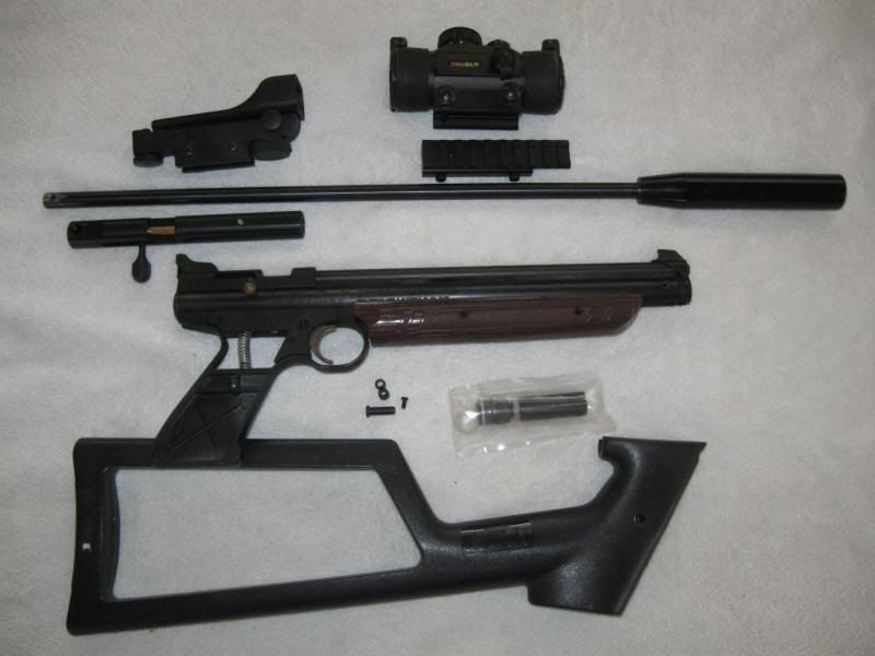

Welcome OG I am a newbee to. I ordered my steel breech kit on the 18th and got it in the 24th. The 24" barrel I ordered at the same time must be back ordered? I have received no e-mails letting me know whats up with my barrel. It took me a little over two hours to install the breech,a .22/air gun to weaver rail,and my TruGlo red dot sight. I'm still working on zero. Railbuggy

We'll get there OG. My 24" barrel got installed yesterday at 9PM, and I had to wait for light to zoom in my reddot. Working on it now. At 30 feet I'm hitting 1"rt & .5"high. Might be my 60 year old wobble.

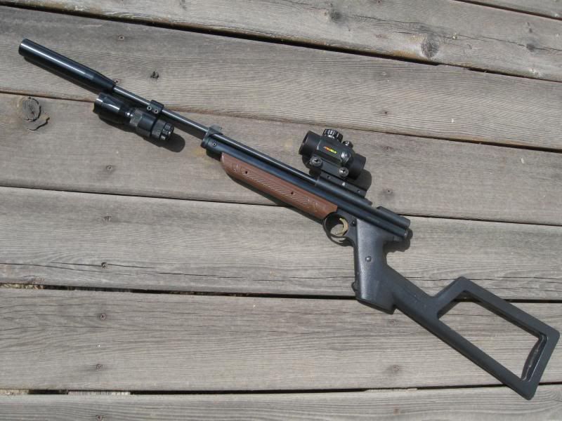

Thanks everybody. I'll get it figured out {maybe} once we get home and settled back into our east Texas routine...and my 'lil shop.Ron, that muzzle brake on your reborn 1377 intrigues me.
