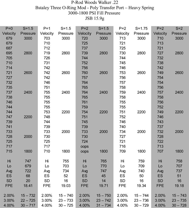

840 fps wit a 31 gr. pellet is 48 FPE, and while that is reachable with a .25 cal MRod, you're not likely to get 16 shots at that power, at least not within a 4% ES or so.... more like 800-810 with those pellets for that many shots....Bob
If you read my post.... I didn't say you couldn't reach 840 fps with the 31 gr. pellets.... what I said was that you are unlikely to get 16 shots at 48 FPE.... Heck you could probably get 1 or 2 shots at 900.... In your other thread, you mention wanting accuracy at 80-100 yards.... That will reduce the ES necessary to less than 20 fps.... and your shot string to maybe 8 shots.... PM BillG and ask him to chime in for good information on long range, high power setups for the .25 MRod.... Bob
