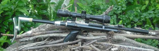

MustangMike
Posts: 6655
Re: Let's see your 2240's.
September 27, 2012, 01:39:50 AM »
im so tempted to post a teaser picture of my 2400kt disco based carbine but idk if i should... might give to much of it away and incase any was curious it aint your every day pcp carbine.. light weight, compact and packs the power of a 22mrod

Mark5043
Posts: 205
September 27, 2012, 01:46:27 AM »
Post it Mike!
I'm working on something similar.It's more or less a folding stock Disco/22XX based sniper..
MustangMike
Posts: 6655
September 27, 2012, 01:55:26 AM »
ignore the long tube at the top that is ment for a different gun of mine.. needed to get it done in matte black instead of the crosman bluing

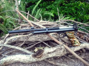

Mark5043
Posts: 205
September 27, 2012, 02:06:55 AM »
Nice!..That's going to be a nasty little PCP. You doing any valve work to jack the power up to M-Rod status?I was able to break 900 fps with mine."14.3 grain pellet..."nothing exceptional as that was done with a 24" barrel"....stock valve by the way.
MustangMike
Posts: 6655
September 27, 2012, 02:10:39 AM »
17in barrel 925-950 fps with 21gr .22 pellets, sooner or later it will be double tubed just because 3 shots at 2400psi well thats a lot of refilling. lol.. but odds are its going to be ran off 3000psi fills
but thats all the details im giving out, this carbine has been a work in progress since Feb so im not spilling any more details or showing any more teaser pictures. once i get it back it will been shipped out at some point to another member here for a good video review of it and its shooting abilities..

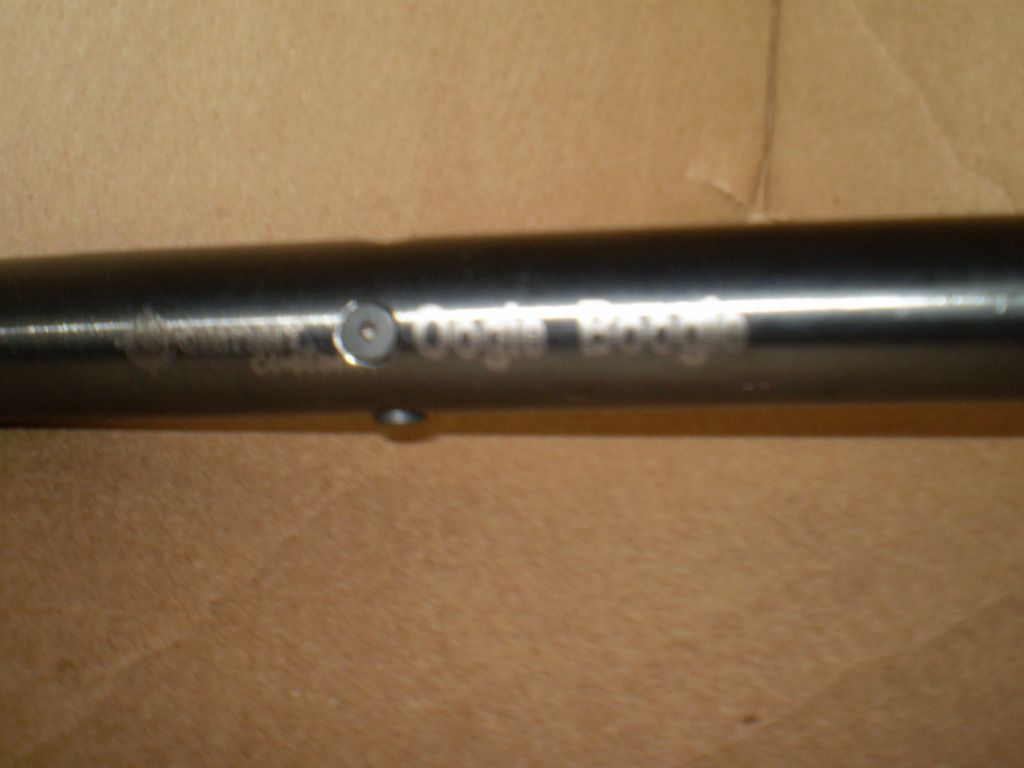

mustang mike,
you are going to need more than a tko to tame that bark!!
heres a preview of my 2300 build coming together now.a 2300 is just a custom 2240
apolgies in advance for the crummy pics.have to adjust the setting on the camera
this is Oogie Boogie
http://disney.wikia.com/wiki/Oogie_Boogie,.so
far has been living up to his name
the tube was lathed and milled to accept a disco valve and jds tank adapter.
the work was done by Lloyd-ss of
http://www.airgunlab.com/
the disco valve's exhaust port sit perfectly centered in the tube. in a disco tube the valve doesnt sit so perfect,great job Lloyd!!!
more to come in a thread about the gun later
