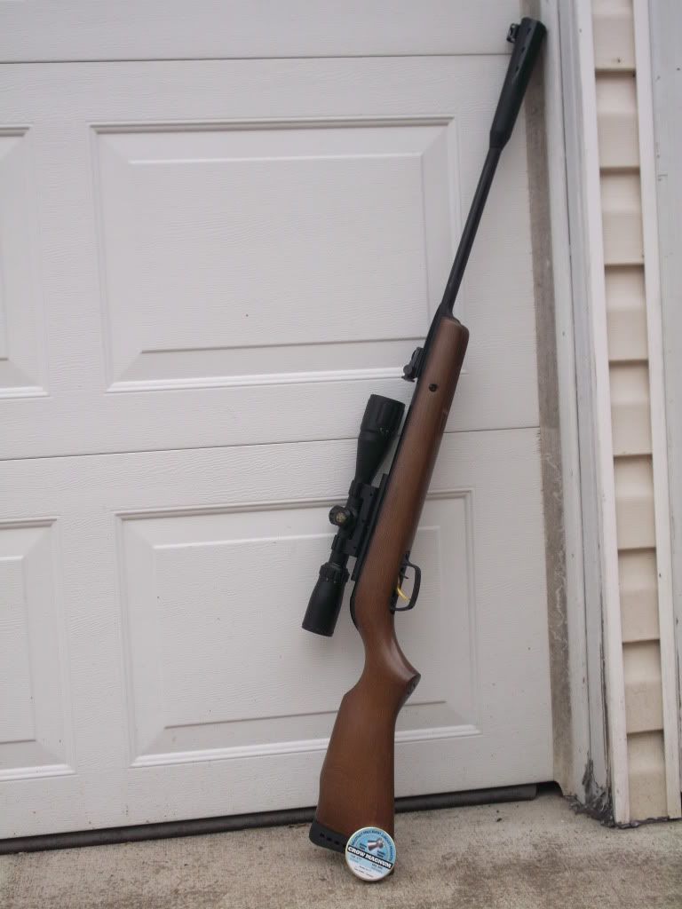

I'm wanting to do a tune and trigger on my Gamo hornet, and was hoping someone could tell me what tune kit I need for my gun. And also if there is anything else I need to get to do the job. Any help is greatly appreciated. Thanks

James Maccari's site located in our mall section of the forum here sell's the Gamo Etc.Express package deal. The kit includes the spring, piston seal or seals and lube to do a tune on your Gamo. Most Gamo's take the Tesla seal in the kit the Apex seal is slightly larger. You will need a spring compressor which is a tool that most members who tune make there own. The site is airrifleheadquarters.com. Also if you haven't put one in yet the GRT trigger is a must and is icing on the tune cake. Ed
