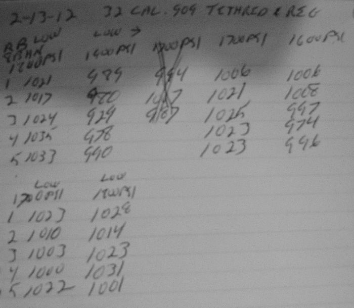

Did a little chrony work with it . Tethered and regulated . Indoors due to rain . Only had time to try some 44 grain , 8 bhn, RB . on low power . Marvin

melloroadman
Posts: 877
Re: Shot the 32 cal 909 today
February 13, 2012, 09:48:54 PM »
I had Will machine me a TJ barrel liner to fit my 45 caliber 909 . 28 inch's long . Then I installed it . I can take it back to the 45 caliber is about a half hour if I want .Marvin

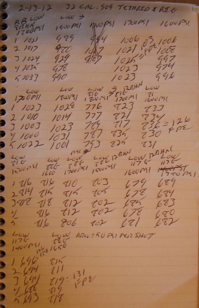

melloroadman
Posts: 877
February 15, 2012, 05:52:40 PM »
Indoors again so no accuracy testing was done . RB were 8 bhn and the bullets were 12 bhn . sized to .3115. 117 grains are a little to much for low . The 81 grain bullets did not do well in my Corsair will have to see what happens in this rifle . Looks like 1600 psi will work on low . Used about 40 psi of air per shot with the 81 grain bullets . Not a power house but it will yield a lot of shots per tank for paper work out to 100 yards . It has more energy than a 22 LR even on low power .Marvin

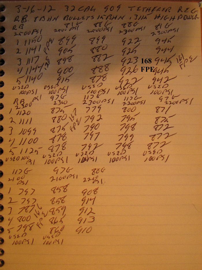

melloroadman
Posts: 877
March 16, 2012, 06:00:08 PM »
Indoors again through the chrony but on high this time tethered and regulated . Same RB and bullets . The rifle is still tuned for the 45 caliber barrel so it can be taken back and forth with out a lot of work . RB are wanting about 2500 psi and the bullets are 2300 -2200 psi . and 100 psi per shot . Marvin
