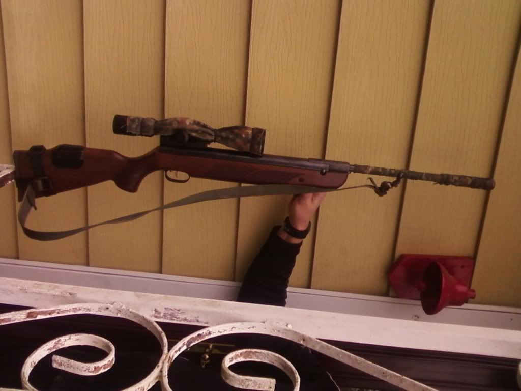

Congrats on your decision, you made a great choice! Here is mine:
