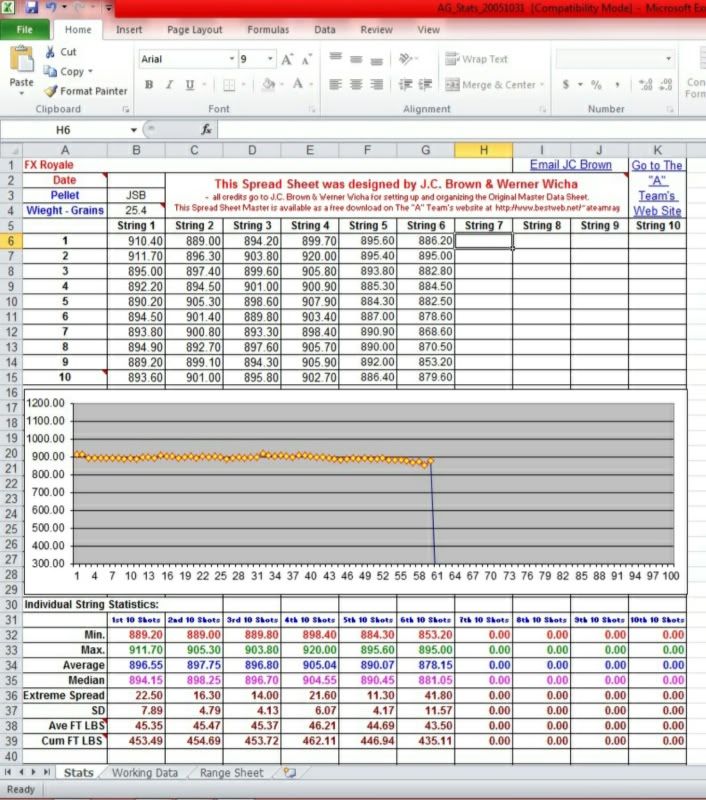

Junkyspace, I just did a 60 shot chrony string with mine and here are the results. I didn't have the curve you do but these guns are really consistent even without the regulator. I started at 220 bar and ended at 160 bar. Tell me what you think.
Keith.

Do you have the regulator keith? Yours is nice and flat.
I'm fine with mine varying a bit -- 50-60 shots is just amazing. I noticed when I started out, I was hitting in the mid-800's at full pressure. I was also aiming it a little high, which could have accounted for it.
Starting at 200 bar, once I got to about shot 55, I got one shot that was audibly and visibly low. It registered around 660 fps. Next two shots was 830-840. Thats when I stopped and pushed the string back to 52.
It's amazing how the valves in these guns keep such a low deviation, fluctuating around 900ish.

No mine is not regulated. I was planning on increasing the FPS a bit but after this string I think I will leave it alone. I wanted it to be consistent at around 910 fps for 40 shots but these results are ok I think. But some of the other owners can probably tell us something different.
BTW...each string only changed by 10 bar.
