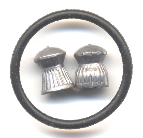

This image shows how a standard size 22 pellet shot from a springer can expand to fit a bore.
I capture SHOT pellets in a tube of wadded up HDPE plastic shopping bags. The capture deformation is very small so pellets captured this way can provide some interesting data.
I have a loose bore Mod95-25 and its accuracy limit is ME = the shooter. Pellets from THAT rifle show skirt expansion (not as much as above) and solid clean rifling marks in the expanded skirt.
