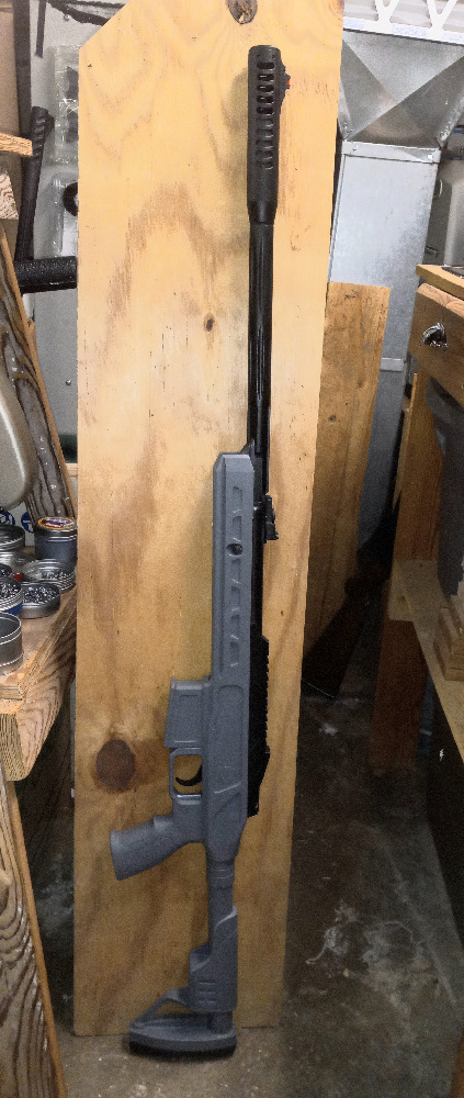

Hatsan Zada 22 Refurb from FS 2025/01/09
Rifle manufacture date 2023. Looks like it was factory refurbished by HatsanUSA. Plain brown box contained "test sheet" from a Hatsan tech.
Basically the Zada is the AirTact action in a grey tacticool stock. I have a couple AirTact 177 refurbs that shoot well, but I'm skeptical all the plastic used will hold up over time. Overmolded palstic barrel/breech and plastic lockup wedge seems risky but still shooting well after 3 years.
The grey tacticool stock stock is very light and has a "flimsy" feel to it. Not a fan of tacticool look but I can accept it if the rifle shoots well.
Shoots WAY left at 20' and no amount of open sight adjustment can bring it back to shooting straight. WHAT is wrong with this thing?

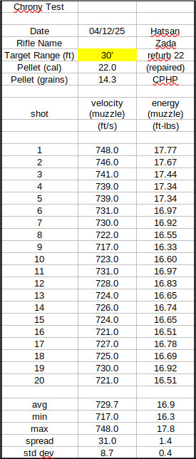

Chronograph data is acceptable good and seems to be improving.
MV plot indicates rifle is still low-level dieseling from my repairs & relube. I may have gone a little too heavy with the tacky marine grease :-/
Regardless of the errant grease the rifle is shooting MUCH BETTER. I'm pretty confident I've got this rifle shooting the BEST it can given its design.
