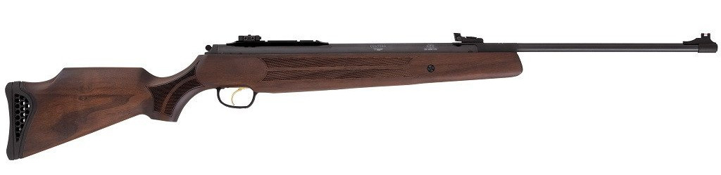

For the time being, I decided to plow on with the loose barrel, for education if nothing else. I wanted to check the muzzle crown of my 135, having never seen it from under the molded front sight base. I tapped the front sight base off for a look. The murky factory crown looked a bit rough and also possibly a little off-center. This would / could explain the accuracy issue quite a bit.Having never done a re-crown, this was a schooling opportunity. I used a domed brass screw hitched in a portable drill and coated with Permatex valve grinding compound (fine), and very little pressure and a forever changing circular pattern. The crown did turn out much cleaner and crisper than before. I know this cannot overcome an asymmetric crown. It’d be easier to create a new crown altogether, on a fresh muzzle surface. But this barrel doesn’t allow ANY shortening, as it would take out the miniscule choke and leave the rain gutter behind it in charge.At this late juncture, I also switched the completely insufficient factory rear guide with a long custom steel guide gifted to me by Mikey quite a while back. The broken-in factory spring went on the guide with a hefty push, not quite tight enough, but I want to get a direct comparison between the factory and custom guides. I didn’t change anything else, or even extract the piston, to this end.It’ll be interesting to see what’s the gun’s cycle and velocity now. Maybe, just maybe, accuracy improves some with the bore scrub and re-crown, too.
